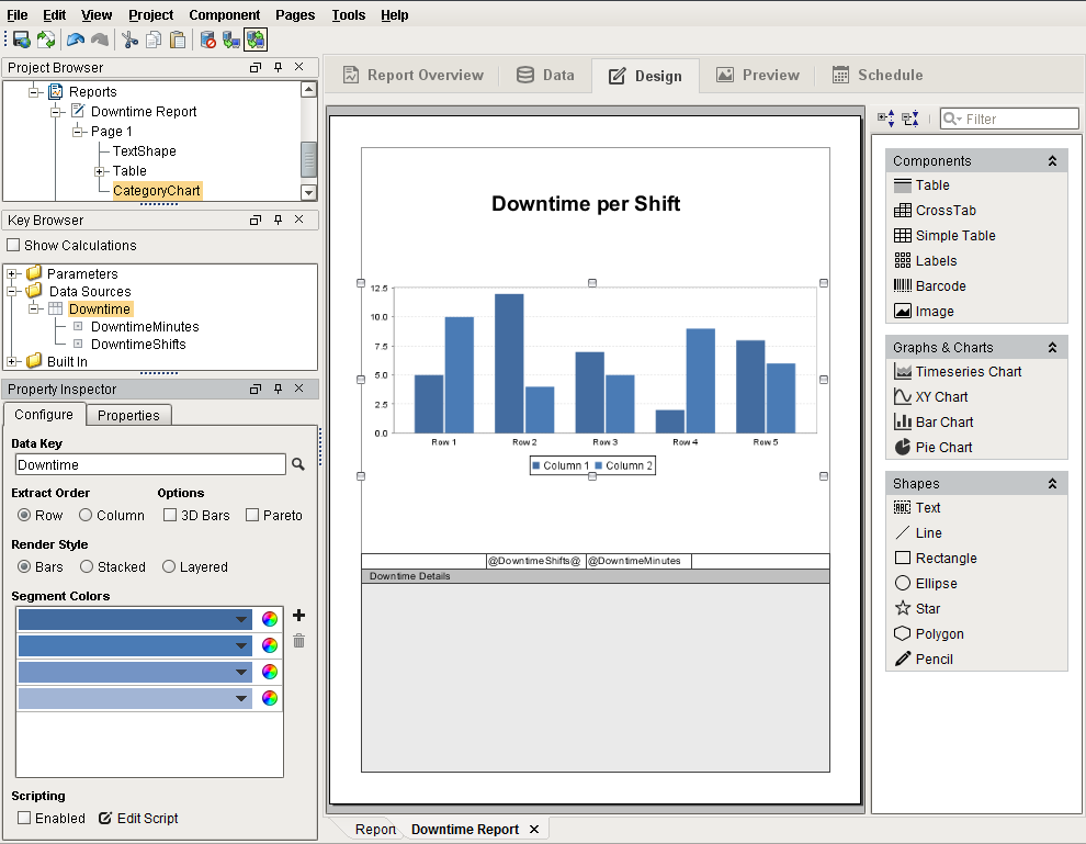

Report Designer Interface​
The Report Workspace's Design tab lets you design reports with the same intuitive feel, familiar layout, and drawing tools that you get when designing windows in Ignition. Just like designing Vision windows, you can design reports using the same familiar drag-and-drop method and choose from a library of graphs, charts, tables, and images.
Looking at the screenshot of the Report Designer, you'll notice that an open Report Resource in the Project Browser can be expanded to provide information at a glance. This tree lets you visualize the relationship and hierarchy of Report Design elements on the page. Find an element in the tree by selecting items on the Design Panel, or find an element on the page by selecting it from the tree. As you do so, you'll notice that the bottom left of the default Report Designer will change to provide configure panels and/or property tables depending on the selected item.
Just below the Project Browser is the Key Browser which provides the Data Keys we use to reference data in our report. The Key Browser is home to all your Data Sources, Parameters, as well as a number of built-in calculation keys to speed you through the report design process. When you configure a data source and switch to the Design tab, a sample of all your queries is run on the Gateway to get information about the structure of your data. Columns in your data are represented as children in the Key Browser tree.
The right side of the panel is where the component palette lives, providing a number of powerful components, charts, and shapes which are used to build the layout and visualization of your report.
Report Design Components​
Designing reports is where the fun begins. The Design Panel has a Report Design Palette with a host of components, charts, and shapes that when used together help you design and create meaningful, informative, and professional reports. Tables are used to collect and store varying amounts of data. Sophisticated charts can be created from the data collected in a table. Images and Shapes can add that extra touch of class and polish making a report stand out.
Just like designing in Vision windows, Report Design components have properties which are editable in the Property Inspector which is located on the lower left side of the Design Panel. Below is a brief overview of the report design tools you can choose from for building your reports.

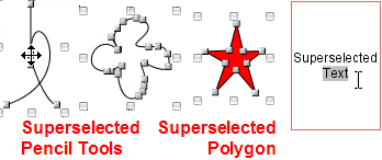

Super Selection​
Super Selection refers to an editing state that some shapes go into when double clicked. Text is the most common of these. When a text box is selected you can move and resize it. When it's super-selected, you can place the text cursor or select a range of characters and insert or delete text. The polygon and pencil are two other basic tools that support Super Selection.
