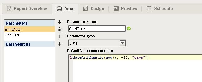

When you first create a report, you start with two parameters: StartDate and EndDate. EndDate will have a default value of 'now()', while StartDate will have a default value of 'dateArithmetic(now(), -8, "hr")'. The default value of the StartDate can be modified from 8 hours to 10 days by editing the Default Value expression.
StartDate Default
StartDate Modified
dateArithmetic(now(), -10, "days")
You can also delete both StartDate and EndDate parameters if you do not need date parameters in your report.

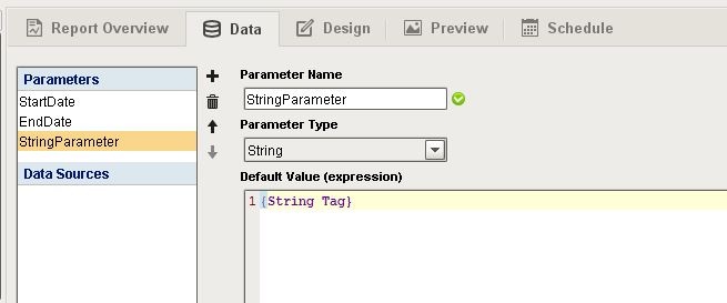

Once created, a default value should be given to the parameter. In addition to expressions, you can also have your default value reference a Tag using the Tag icon on the right of the expression area.

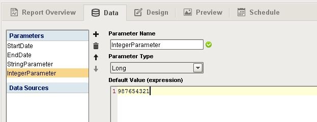

You can also use a literal value. Normal Expression languages syntax applies, so dates and strings must be wrapped in quotation marks, but numerical values can be written without quotes.

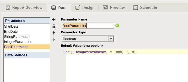

Finally, you can reference other parameters. In the example below, BoolParameter is referencing the value of IntegerParameter.
if ({IntegerParameter} = 1000, 1, 0)
note
When referencing other parameters, you must type the name of the parameter exactly within a set of curly braces , including capitalization. Also, you can only reference parameters that are above the current parameter. Thus, while BoolParameter can reference the IntegerParameter, the IntegerParameter may not reference BoolParameter.
