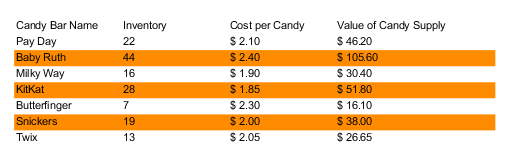

Tables are a major part of Ignition Reporting. Tables are objects that display data in a structured, repetitious format giving users the ability to flexibly layout and organize tabular data in a variety of ways. Their complexity can range from trivially simple to complicated, but fundamentally they do the same thing - take the data given to them and repeat it in a structured way for each row of the data provided. The Reporting engine will automatically create new pages to fit all data within the Table's boundaries while applying formatting preferences each step along the way such as font, size, layout and alignment. Combine that feature with powerful data manipulation and expressive layout tools, and you get an object that often forms the basis of your reports.
Let's start by looking at the various parts of the Table component and move into more features.

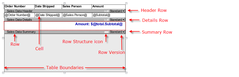

Anatomy of a Table​
A table has multiple sections, each with its own properties. By default, a Table consists of three sections:
  • Table Body - Grey area at the bottom of the table template. You can stretch and shrink the table boundaries to position and size a table.
  • Table Rows - There are three types of table rows: Header, Details, and Summary. A table row can also be structured or unstructured. More information on these row types can be found on the Table Rows page.
  • Text Shapes / Cells - are available only in a structured table row. In Reporting, Text Shapes are commonly referred to as cells. Can select multiple cells with alt or shift.
Text Shapes or Cells
If you're looking in the Project Browser tree, you'll notice a node called 'Text Shape.' In Reporting, the Text Shape is also called a 'cell.' For the sake of clarity, Text Shapes will be referred to as 'cells,' unless we are referring to the Text Shape component.

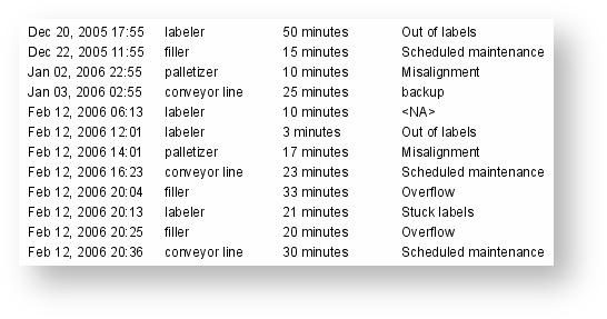

The following example shows the basic anatomy of a table with data populated in the Header, Details, and Summary rows. Once you're finished designing your report, go to the Preview panel and check your results. You can continue to navigate between the Design and the Preview panels making changes until you get your report just right!

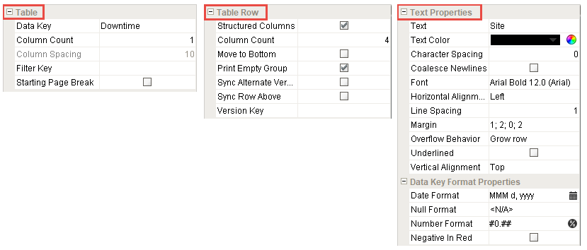

Each section (i.e., Table, Rows, and Cells), when selected, has its own unique properties (shown below), along with some common basic properties that appear in the Properties tab of the Property Inspector. Refer to the Table page in the Appendix for a complete list of all Table properties.
Table Column Count vs Row Column Count
When modifying properties on a section of the Table, always pay attention to which section you selected. Some property names on one section may look similar to properties on a different section. For example, Table Rows have a Column Count property that adds a new column to the row, but the Table Body section also has a Column Count property that will cause the same table to spill out horizontally on the same page. This is great for landscape pages, but on portrait oriented pages it can cause some of the data to be rendered on an unprintable area of the report!

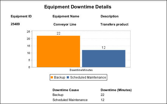

By default, when you initially create a table all the row types are structured. A structured row has a variable number of columns and allows you to organize your text based table data, whereby, an unstructured row is highly customizable allowing you to place images, text shapes, and charts within the table row. Unstructured rows are perfect for placing charts anywhere within the row of the table. An unstructured Details row typically works best when used in conjunction with Grouping Data Inside of Tables or Nested Queries so that each row has a chart with data from that group or query.
