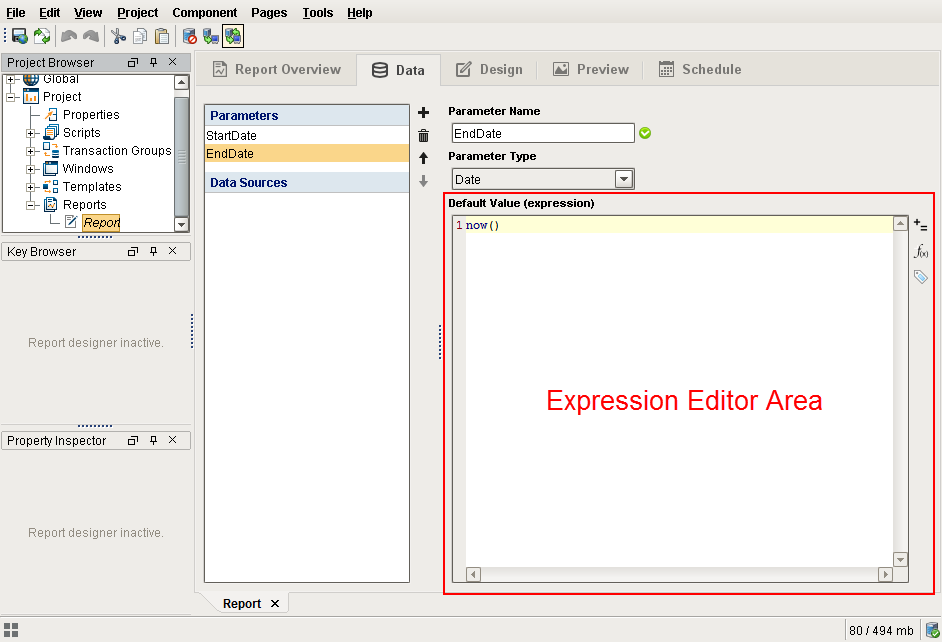

Parameters are the way you get dynamic data into your charts. These properties are exposed on the Report Viewer component and can be bound to other components to allow your users to select what report data they want to see. You can use these to set up dates, time ranges, area selectors, titles, and anything else you want in your report.
By default, StartDate and EndDate properties are automatically created for you because they are almost always used to filter report data. You can, of course, delete them if you don't need them.

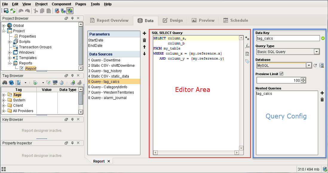

The Query data source types share some common features in the UI, and they all return what is essentially a Dataset. If you take a look at the image below, you'll see we outlined two main areas of the Basic SQL Query data source type. By default, the largest part of any Query panel is taken up by the central Editor Area. This space is tailored for each query type. On the right side of the Data panel, we have a "Query Configuration" area. In the screenshot, you'll see there are options for the Data Key, Query Type, Database, Preview Limit and Nested Queries. Of these, Data Key, Query Type and Nested Queries are shared among all Queries, while Preview Limits are conveniently available in SQL query types. Here is some brief information on each type:
  • Data Key- The identifier we will reference when we design our reports. The Data Key needs to be unique, can not contain special characters (spaces, underscores, dashes are allowed), and must start with a letter. We added a convenient validator to help detect name collisions.
  • Query Type - gives you a convenient place to change the type of query.
  • Nested Queries - All of the query-based Data Source types can have nested queries in them. That is, for each row of returned data, a second query can be run based on the results in that row. You can have multiple sub queries for each row, and nest queries as deep as you want. This is particularly useful when you have data organized into runs and want to see historical data for each run.
  • Preview Limit - Allow you to choose to limit the number of rows returned from a query when a report is being generated in the Preview Panel, and when data is sampled for the purposes of generating Data Keys in the Designer. If supported by your database, this makes it much easier to craft and preview deep query structures without the overhead and wait-times of long-running queries.
