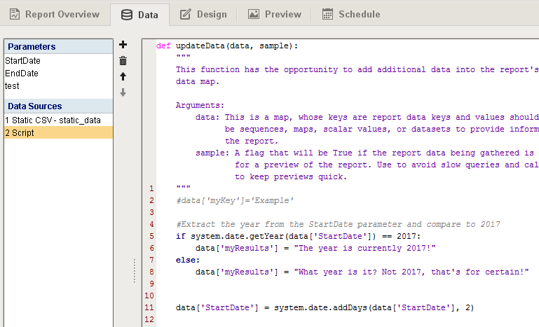

Where the 'keyName' is the name of your data key. Thus, reading the value of a parameter, such as the initial StartDate parameter, can be accomplished by using system.date.getYear() and an if-statement.
Python - Accessing a Parameter's Value
# Extract the year from the StartDate parameter and compare to 2017.
if system.date.getYear(data['StartDate']) == 2017:
# Do work here if the year lines up.
Of course, we can write back to the key and override it's value:
Python - Overriding the Default StartDate Parameter
# This line would override the default StartDate parameter by add adding a day.
data['StartDate'] = system.date.addDays(data['StartDate'], 1)
Additionally, this allows you to expand the Accessing a Parameter's Value example above by creating a new key:
# Create a new key and assign it one value if our condition is true...
data['myResults'] = "The year is currently 2017!"
else:
# ...or assign a different value if the condition is false. This way we can always assume the key 'myResults' exists.
data['myResults'] = "What year is it? Not 2017, that's for certain!"

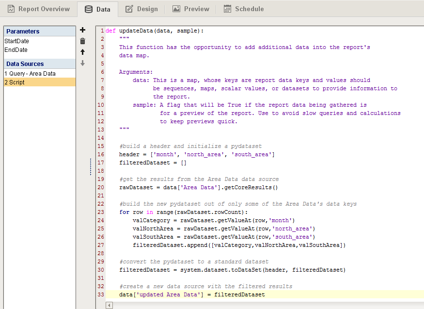

Say we have a query data source named "Area Data" which contains four columns: month, north_area, south_area, and t_stamp. If we need to build a new data source without the t_stamp column, we can use the following code:
Python - Building a New Data Source
# build a header and initialize a pydataset
header = ['month', 'north_area', 'south_area']
filteredDataset = []
# get the results from the Area Data data source
rawDataset = data['Area Data'].getCoreResults()
# build the new pydataset out of only some of the Area Data's data keys
for row in range(rawDataset.rowCount):
valCategory = rawDataset.getValueAt(row,'month')
valNorthArea = rawDataset.getValueAt(row,'north_area')
valSouthArea = rawDataset.getValueAt(row,'south_area')
filteredDataset.append([valCategory,valNorthArea,valSouthArea])
# convert the pydataset to a standard dataset
filteredDataset = system.dataset.toDataSet(header, filteredDataset)
# create a new data source with the filtered results
data['updated Area Data'] = filteredDataset
