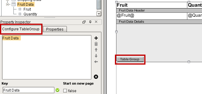

To make a Table Group, you simply need to click the Make TableGroup button in the Configure Table tab of your table. You will be able to tell that it worked when you notice a Table Group icon displayed in the lower left corner of the table component, and your Configure Table tab has now changed into a Configure TableGroup tab.
We can see our original table listed in the Configure TableGroup tab, and we have the option to add additional tables by clicking the plus icon. Adding a child table will add a table that is a child to the table that is currently selected in the Table Group list. Adding a peer table will add a table that is a peer to the currently selected table. We can add as many of each of these as we need.

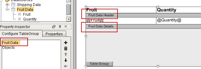

As you can see from the image above, the Table Group hierarchy can get quite confusing very quickly. It is important to understand how each part of the Table Group works, and to always be aware of which table you are actually looking at inside the Table Group. To view a different table within the Table Group, simply select it from the hierarchy. The table displayed in the design area will switch depending on which table you selected.
Fruit Data Selected​
Fruit Data table configuration visible on the Design tab
Objects Selected​
Objects table configuration visible on the Design tab
This allows you to get a quick preview of how each of the tables within the Table Group are set up. To go in and configure an individual table within the Table Group, select it from the hierarchy and then click on the table object in the design area. The Configure TableGroup tab in the Property Inspector should change to the Configure Table tab, and will display properties relevant to the table you had selected. This allows you to add a Data Key, set grouping, configure relevant row styles, and format the table in any way that you want. After configuring the table, we can navigate back to the Table Group configuration by clicking on the Table Group icon in the bottom left corner of the table.

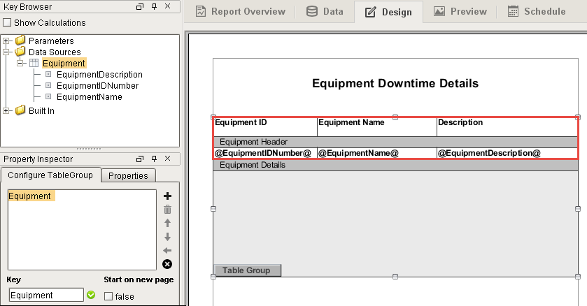

  1. Once you have your Data set up, click on the Design tab and add a Table component to your report.
  2. With the table created, add a Header row to the table. Drag all of your Equipment details into the table, and add header titles for each column. Equipment table column headers for this example:
    • Equipment ID
    • Equipment Name
    • Description
  3. Now that we have a base table, click the Make TableGroup button at the bottom of the Property Inspector.
  4. Once you make your TableGroup, you're ready to create a Child Table. In the ConfigureTable Group tab, make sure the Equipment table is selected and click the plus icon and select 'Add child table.' The table you create becomes a child of the Equipment table. By default, the child table will be called Objects.

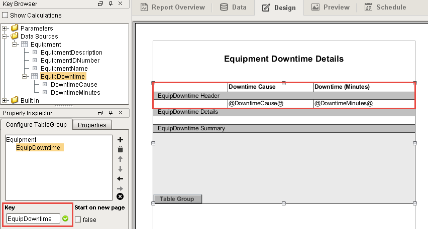

  5. A Child Table has its own datasource and uses a nested query to pull data from the database. Double click on the child table to select it and see the details for that table.
    note
    You can switch back to the Configure TableGroup tab by clicking on the Table Group button in the lower left of the Table component.
  6. Drag the child datasource (i.e., EquipDowntime) from the Key Browser to the Key field in the Configure TableGroup tab.
  7. Next, add a header row with column name text:
    • Downtime Cause
    • Downtime (Minutes)

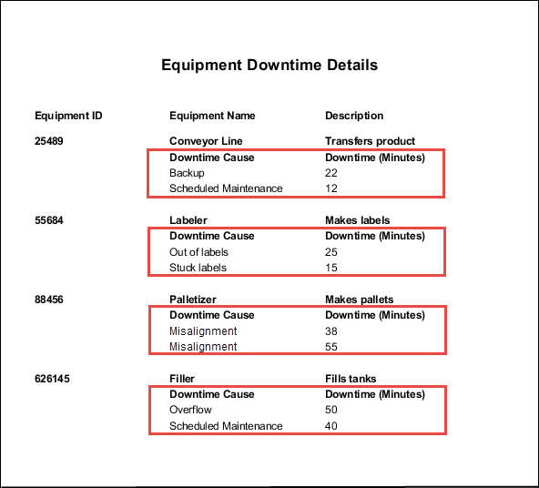

  8. Drag your columns from the Key Browser to the appropriate columns in your table.
  9. Go to the Preview panel to view the report. You'll notice the Child Table is now embedded in the parent table.
