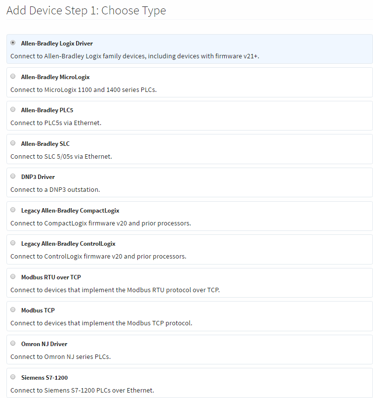

Here at Inductive Automation, we created our own OPC-UA server and device drivers to connect with. To quickly get connected to one of your devices, go to the Configure section of the Gateway webpage and scroll down to OPC-UA Server > Devices. The Device page will appear showing all of your installed devices. To add a new device, click on the on the blue link, Create new Device. Scroll through the list of devices, and click the radio button next to the type of device connection that you are interested in:
