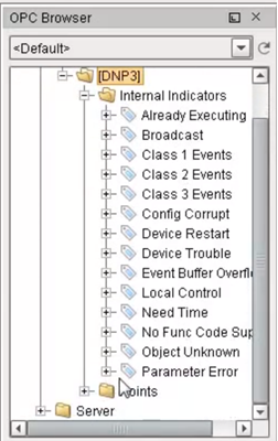

Internal Indicators​
Each response received from a connected outstation will contain an Internal Indication (IIN) bit field. This field indicates certain states or error conditions in the outstation. IINs are mapped to read-only points, indicating the following:
  • Broadcast message received (Broadcast)
  • Additional Class 1, 2, or 3 event data is available (Class 1 Events, Class 2 Events, Class 3 Events)
  • Time synchronization required in the outstation (Need Time)
  • Some output points are in local mode (Local Control)
  • An abnormal condition exists (Device Trouble)
  • The outstation device has restarted (Device Restart)
  • Function code not implemented (No Func Code Support)
  • Object Unknown (Object Unknown)
  • Request parameter error (Parameter Error)
  • Outstation event buffer overflow (Event Buffer Overflow)
  • An operation is already executing (Already Executing)
  • Configuration corrupt (Config Corrupt)

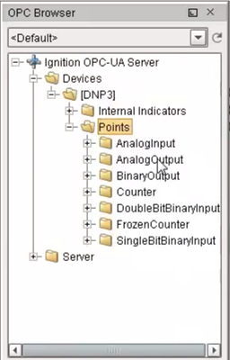

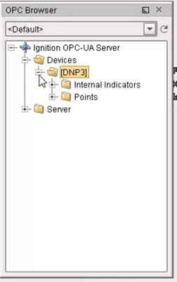

Browsing DNP3 Points​
Inductive University
About DNP3 Addressing
Watch the video
When the driver (master) connects to a device (outstation), an integrity poll is performed. Any DNP3 objects returned in the response that fall under the Point Type categories listed in the table on the right are mapped to the OPC server with the appropriate index. (For example, g40v1i2 corresponds to an AnalogOutput point, variation 1, index 2.)
To see the points mapped, you can go to the Designer, open the OPC Browser, and drill down to the DNP3 connection node.
