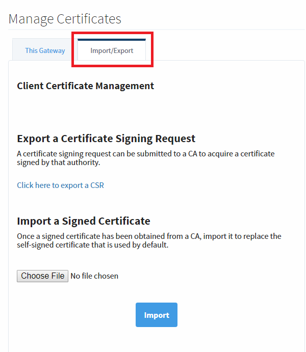

  1. Go to the Configure section Gateway Webpage and click on the link for the OPC-UA Server > Certificates page.
  2. Click on the Import/Export tab.
  3. Click on the 'Click here to export a CSR' link to generate the Certificate Signing Request (CSR) file.
  4. Now that you have the CSR, you will need to send the file off to be signed. Who you send the file to differs depending on the UA server you are trying to have Ignition connect to. For example, if using the built-in OPC-UA server on a Bedrock Automation PLC, then you can submit the CSR to Bedrock. Always consult the UA server's documentation for recommendations on who to send the CSR to.
    This step may take some time, as the entity you sent your CSR to will need to process the request, and generate a unique Signed Certificate.
  5. Once processed, the entity that processed your CSR will respond with a Signed Certificate. Again, on the OPC-UA Server > Certificates page, import the Signed Certificate by using the Browse button.
  6. Click the Import button. After uploaded, you will see a confirmation at the top of the page stating that the file was uploaded successfully.
  7. With the new certificate, you can now create an OPC-UA connection to the UA server.
