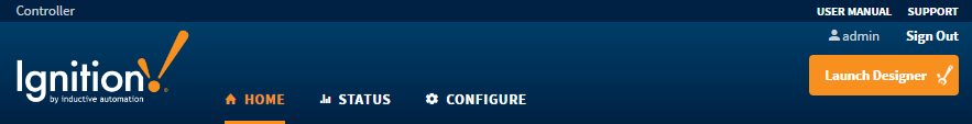

The Designer is launched from the Gateway homepage by clicking on the Launch Designer button on the top-right of the Gateway webpage.

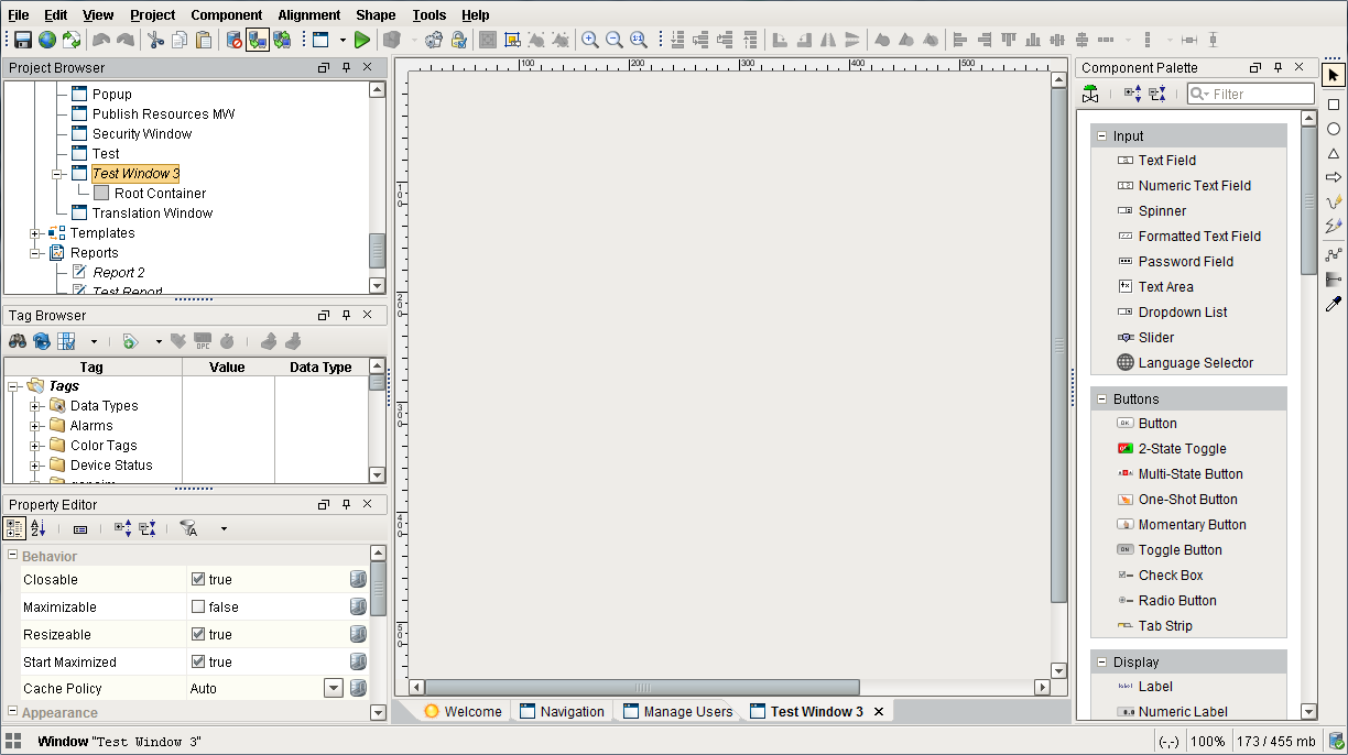

Designer's Workspace​
The Designer workspace is centrally located and organized by panels. Some of the panels include a Project Browser, Tag Browser, Property Editor, and Component Palette. These panels can change depending on the type of resource you are currently editing. For example, if you are editing a Window, your workspace will be the Window Designer. If you're editing an Alarm Notification Pipeline, your window will be the Pipeline Block Editor. If you are editing a Report, your window will be the Report Designer. Each type of workspace has panels that are only valid when that workspace is active.

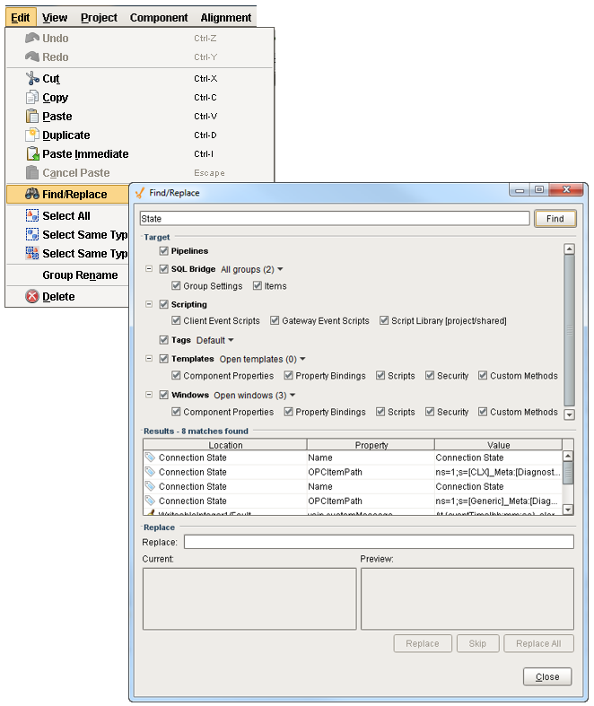

Find and Replace​
The Find and Replace is a handy tool in the Designer workspace. You can search your entire project for specific components, properties, scripts, and more. You can even use the replace command to make mass changes expeditiously to a project with very little effort.

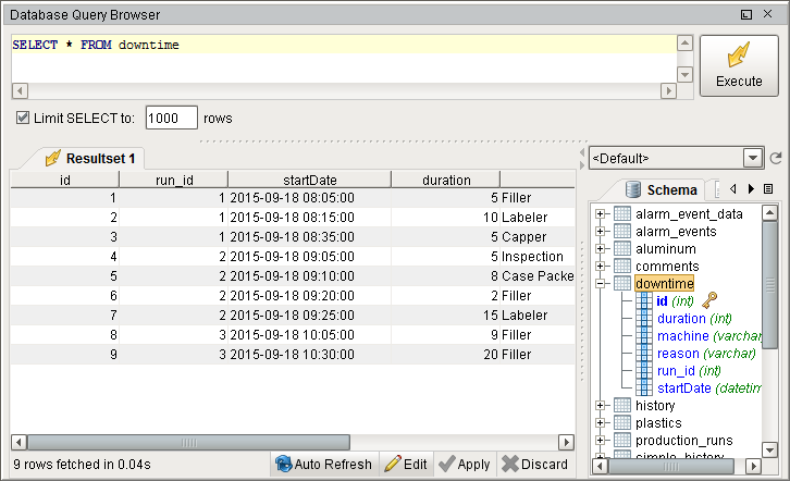

Query Browser​
The Database Query Browser is a very convenient tool that lets you make simple edits in a database table, and interact with all of the databases that Ignition is connected to (i.e., running queries, browsing tables and schemas). It is very common during the course of project design to inspect the database directly, or to experiment with a SQL query to get it just right.

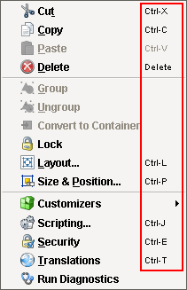

Keyboard Shortcuts​
There are a lot of ways to speed up your development once you are familiar with how Ignition works. There are many keyboard shortcuts in Designer that are listed throughout the Designer interface alongside menu options.
