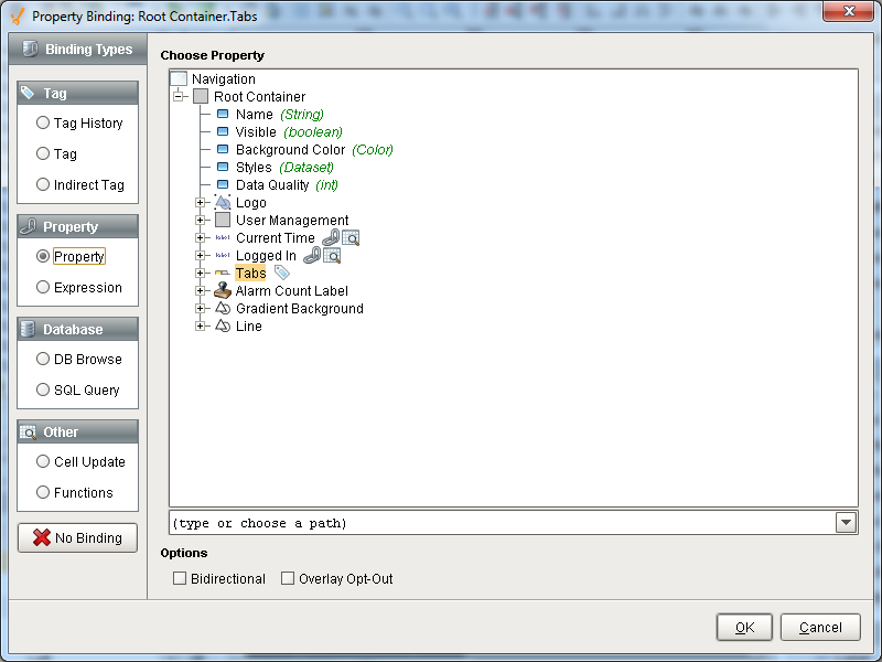

Property Binding Types​
A property can have many different types of bindings, for example it can have a Tag or an Expression binding. Instead of setting a label statically, the text might change based on a PLC value or on-screen selection. There many ways to bind your components to show values from PLCs, databases, other components, or user input. You can even bind some or all of the properties on each component. You can bind component values using:
  • Property - simply binds one property to another. When that property changes, the new value is pushed into the property that the binding is setup on.
  • Tag - binds a property directly to a Tag which sets up a Tag subscription for that Tag, and every time the chosen property changes, the binding is evaluated, and pushes the new value into the inbound property.
  • Indirect Tag - similar to the standard tag binding except that you can introduce any number of indirect parameters to build a tag path dynamically in the runtime.
  • Tag History - used for Dataset type properties. It runs a query against the Tag Historian.
  • Expression - is the most powerful type of property binding. It uses simple expression language to calculate a value which can involve lots of dynamic data.
  • Database Browse - is equivalent to the SQL Query binding except that it helps write the queries for you.
  • SQL Query - is a polling binding type that runs a SQL Query against any of the database connections configured in the your Gateway.
  • Cell Update - enables you to easily make one or more cells inside a dataset dynamic. This is useful for components that store configuration information inside datasets like the Easy Chart.
  • Function - is a generic binding type that lets you bind a dataset property to the results of a function. It allows any of the function's parameters to be calculated dynamically via Tag and property bindings.

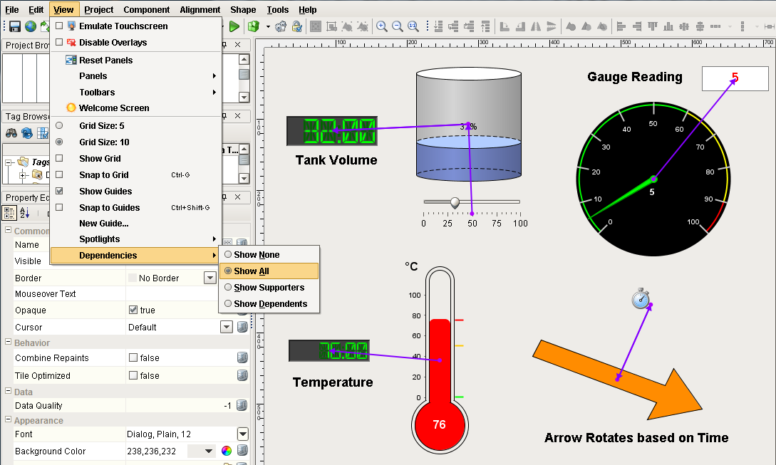

In this screenshot, property bindings were set to make these random components do something. In the Designer, you can quickly view dependencies to determine what is linked to what. As shown below, a line is drawn from the Slider to the Tank letting you know the Tank is bound to the Slider. You can graphically see what components are bound to each other by using the View > Dependencies > Show All command.
Basic Bindings - View Dependencies

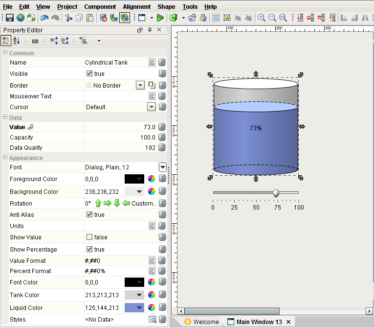

The simplest of all the binding types is the Property binding type. You can link one property on the screen to another property in the same window using the bind button next to the property. When the property you've bound to changes, the new value is pushed into the property that the binding is setup on. For example, say you want a Tank to reflect the value of a Slider component. You can bind the 'Value' property of the Tank to the 'Value' property of the Slider. So each time the Slider value changes, the Tank will update to the same value.

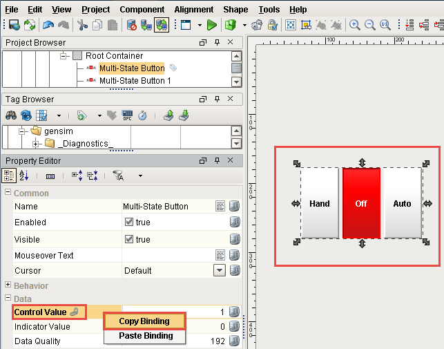

Copying Bindings​
When you copy a component, all bindings, scripts, etc. are copied along with it, but you can also copy a property binding from one property to another. This can be on the same component or a completely different component. The only prerequisite is that both property bindings must use a compatible property type. (i.e., A binding that resolves to a string will not work on an integer property, etc.).
Here's how to copy a binding property:
  1. In the Designer, click on a component.
  2. Select the bound property and right-click.
  3. Choose Copy Binding.
  4. Select another property on the same component or any property on another component.
  5. Right-click and select Paste Binding to apply the binding to the new property.
