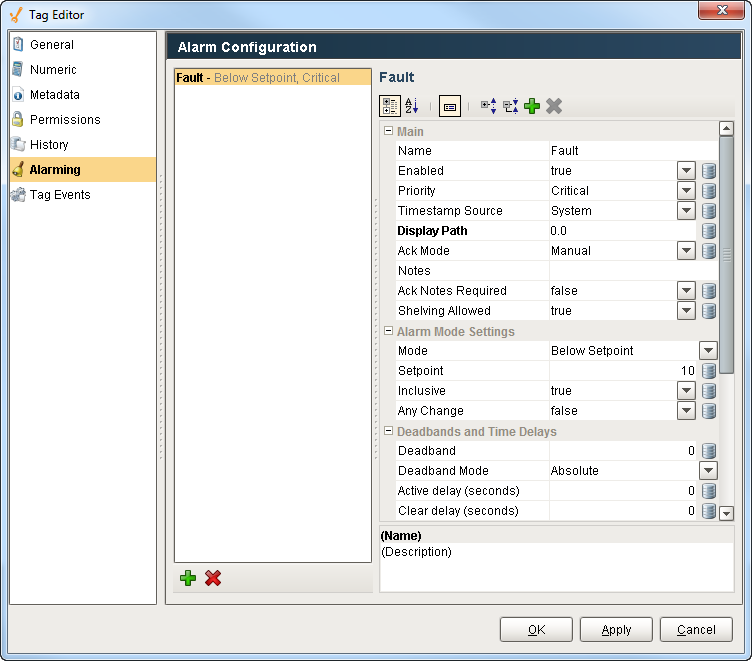

Setting up Alarms​
Anything is possible with alarms! Alarms have a ton of settings that you can use to create almost any type of alarm in Ignition. You can configure alarms with one alarm on a tag, multiple alarms on a tag, and even add alarms in UDTs so every instance of that tag will automatically have alarms configured when a new instance of your tag is created. You can use the alarm settings to create alarms that equal or don't equal a setpoint, above or below a setpoint, between setpoints, outside setpoints, dynamic setpoints, out of range, bad quality, etc. The conditions are limitless.
Alarms are super easy to create. All you have to do is select your tag, add an alarm, configure your alarm settings, and you're in business.
Information about configuring alarms can be found in Alarming Properties in the Tag Intro and Setting Up Alarms sections.
Alarm Setup on Tag

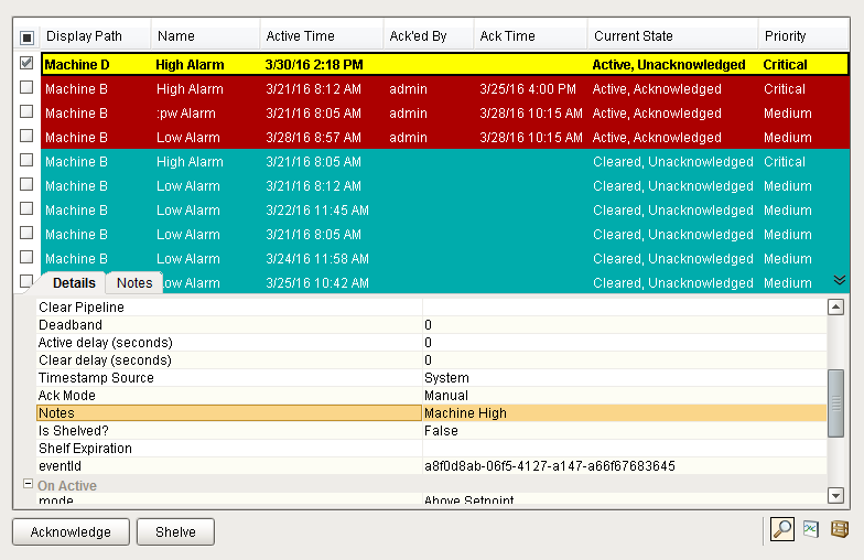

How to Monitor Alarm Status​
Setting up the Alarm Status Table works like magic! All you have to do is drag the Alarm Status Table component onto your window, and the current alarms are displayed immediately into one view! It is highly customizable and can be configured to show active, unacknowledged, cleared, and acknowledged alarms. You can filter on Alarm Status properties, show or hide alarm property information, reorganize columns, view alarm details, notes and history of an alarm, not to mention, Acknowledge or Shelve a selected alarm.
Using an Alarm Status Table to Monitor Alarm Status

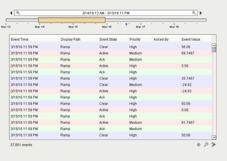

How to View Alarm History​
The Alarm Journal stores historical information about alarms in a database. It stores basic data about alarms that have occurred, such as their source and timestamp, associated data on an alarm, and the values of an alarm's properties at the time the event occurred. It captures all status changes for each alarm, as well as acknowledgement to an external SQL database of your choosing. To begin viewing alarm history, all you need to do is create an Alarm Journal Profile in the Gateway webpage.
Like the Alarm Status Table, you can filter on alarm history properties. The alarms are color coded so you know what each status represents. The date range is a very common filter type since users typically want to filter for alarm events within a specific period of time.
View Alarm History With the Alarm Journal

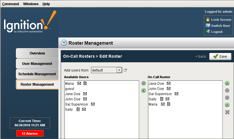

Alarm Notification​
Alarms may also generate notifications that are delivered to users. This allows Ignition to immediately communicate events and problems to your users. The Notification system has access to Ignition's Authentication Profiles, so users can easily be added to notification rosters. Schedules can be created, which in turn allows users to receive notifications only when on-schedule, so there is no need to worry about notifying a supervisor or manager in the middle of the night.
Alarm Notification Roster Management from the Client Window

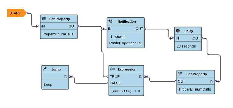

Using Alarm Notification Pipelines​
The Alarm Notification Pipeline feature is an innovative tool that lets you easily create routes for your alarms. By designing your own alarm notification routing, you have control of what happens when an alarm goes active, when an alarm is sent out, and who receives the alarm notification.
The alarm notification pipeline has a simple drag-and-drop interface so you can build various types of alarm logic. Its built-in pipeline block functionality lets you delay sending alarm notifications, escalate higher priority alarms to a different group of users, consolidate multiple alarms so recipients aren’t flooded with messages, and distribute specific alarm types to different contact groups.
Alarm notification pipelines can be very simple to very complex. In this simple notification pipeline, when an alarm is triggered, the people listed in the On-call Rosterare notified via Email. If no one acknowledges the alarm in 20 seconds, the alarm notification is routed back to the same people listed in the On-call Roster.
Alarm Notification Simple Alarm Pipeline
In this more complex alarm notification pipeline, if an operator doesn't respond to the alarm after three attempts, the pipeline jumps it to another pipeline (possibly an escalation pipeline).
Alarm Notification Complex Alarm Pipeline
