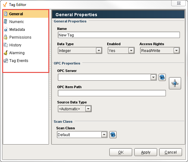

Tag Configuration in the Designer​
o configure a Tag, right-click a Tag and select Edit Tag, or right-click the Tags folder in the Tag Browser and use the New Tag option to select a new Tag type (The example below is an OPC Tag). The Tag Editor window is displayed and you can now set the properties for that Tag. The Tag Editor window has the following sections depending on the type of Tag you are creating: General, Numeric, Metadata, Permissions, History, Alarming, SQL Query, Expression, and Tag Events.
General Properties​
Properties common to most Tags are as follows:
PropertyBinding/Scripting NameDescriptionDatatypeApplicable Tag Type
NameNameHow the Tag will be presented and referenced in the system. The Tag path will be the provider, the folder structure, and this name.StringOPC, Query, Expression, Derived, Client
ValueValueThe value of the Tag. Can only be modified if the Tag allows value writing and the user has sufficient privileges.
This property is conditionally writeable meaning the system.tag.addTag has a parameter specifically for changing the value of a Tag on creation, but system.tag.editTag may not change the Value of Tag. Instead, use system.tag.write.
Object (depends on the datatype of the Tag)OPC, Query, Expression, Derived, Client
Data TypeDatatypeThe data type of the Tag. It is important that this be set as correctly as possible with regards to the Tag's underlying data source. The Tags system will attempt to coerce any raw incoming value (for example, from OPC or a SQL query) into the desired type.String or Integer
See valid values.
EnabledEnabledWhether the Tag will be evaluated by the scan class. If false, the Tag will still be present, but will have a bad quality.BooleanOPC, Query, Expression, Derived, Client
Access RightsAccessRightsSpecifies the access level allowed to the Tag: Read/Write, Read only, or Custom. If Custom, the Tag will use the permission settings.N/A
The Access Rights of a Tag is not directly editable. However, the value can be modified manually through the Tag Editor window.
In regard to scripting, both system.tag.addTag and system.tag.editTag have dedicated parameters that allow Access Rights manipulation.
