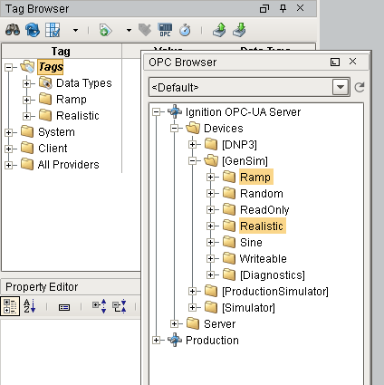

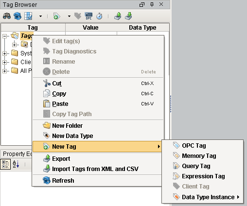

Tags are created in the Designer, either manual by right-clicking in the Tag Browser and selecting New Tag, or if you already have a device set up, by opening the OPC Browser and dragging tags or folders in. See Browsing and Creating OPC Tags for more information.
| Manually Create Tags | Using the OPC Browser |
