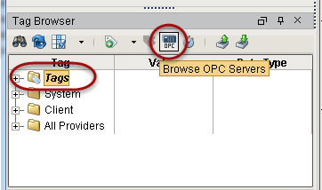

  1. In the Tag Browser, select the Tags folder and click the Browse OPC Servers icon. The OPC Browser is displayed and you can browse all of your OPC connections. By default, you've got a connection to the internal Ignition OPC-UA Server, which has any devices that may be connected. Browse the devices and find some tags that you're interested in.

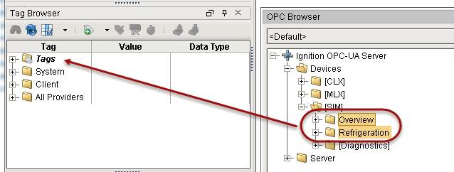

  2. From the OPC Browser, highlight the tags (for example, as in the picture below, both folders inside the SIM folder) and drag them to the Tags folder in the Tag Browser. You can drag individual tags or folders. When you drag folders, Ignition keeps the same hierarchy as the PLC. As soon as you drag the tags into Tag Browser, you can see their values being updated in the Tag Browser.
    You now have some Tags. You can see their values come in and start updating automatically. By default, they update at a rate of 1 per second.

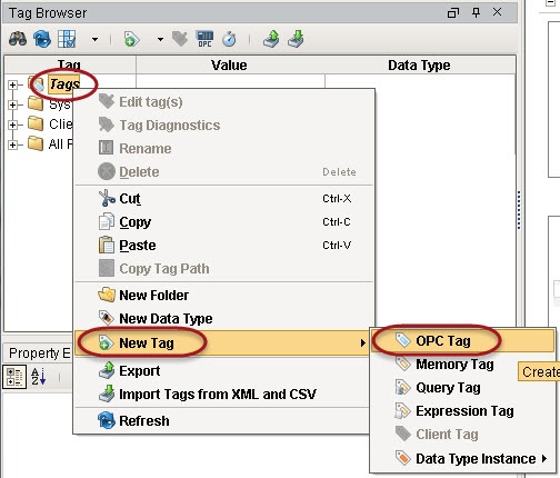

You can create OPC Tags manually when you can't find them using the OPC Browser, or the device does not support browsing.
  1. From Tag Browser, right-click on Tags or a folder of your choice and select New Tag > OPC Tag.

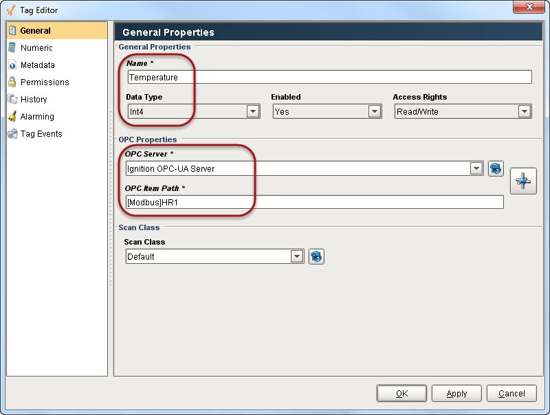

  2. In the Tag Editor window, as an example, you can set the following values:
    • Name: Temperature
    • Data Type: Int4
    • OPC Server: choose Ignition OPC-UA Server from the dropdown
    • OPC Item Path: [Modbus]HR1, the Modbus device name goes in the square brackets then you give the address to PLC which in this case is the HR designator plus 1 as the Modbus address. The Modbus Specific Addressing section, explains how your can construct these addresses.
  3. Click OK.
    Now you can see the Temperature tag in the Tag Browser.
