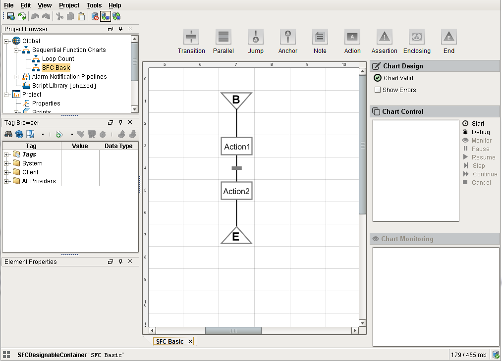

Simple Visual interface​
Charts elements are drag-and-drop, and work similarly to the components you are used to using in the rest of Ignition.
Chart Elements​
Charts are comprised of elements, and these element perform the work in a SFC. Each element does something different, but they generally serve to either control the flow of the chart, or execute one or more Python scripts.

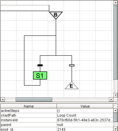

Chart Flow​
Charts always flow in the same way. They start at their begin step, and the logic of the chart typically flows from the top to the bottom, however charts are able to loop back to previous steps. Doing so allows for looping logic to be built directly into the chart. Flow of the chart can be halted by a Transition element. The state of the Transition can update in realtime, so a chart can pause until a user approves the chart to move on.

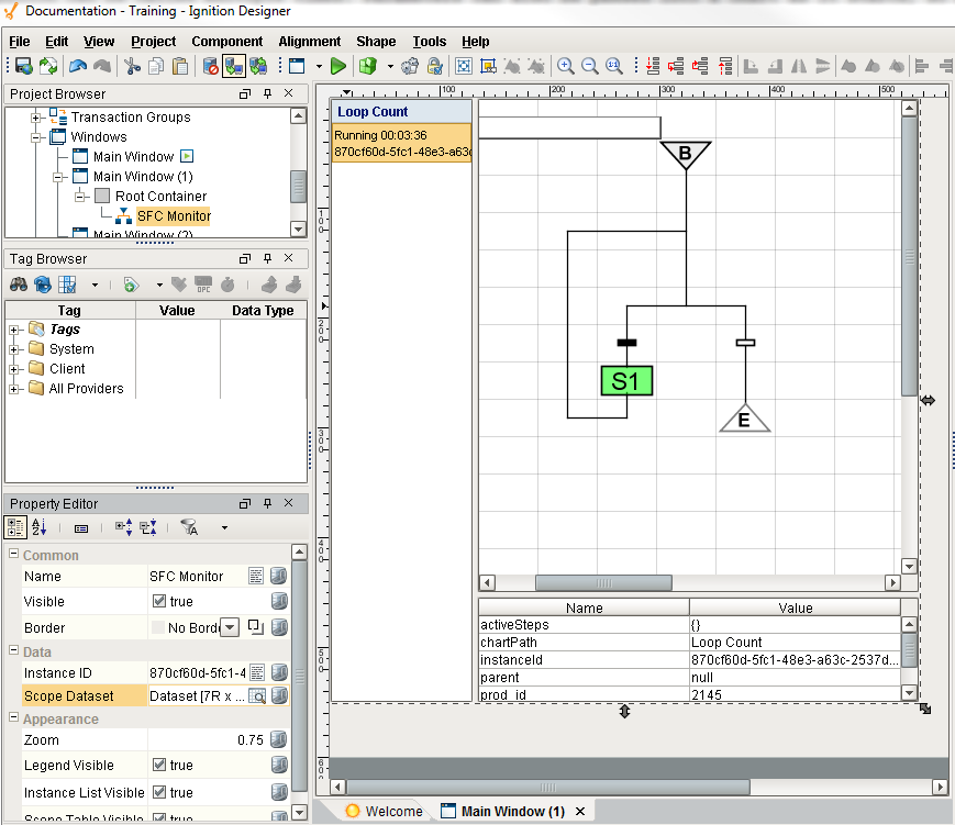

Monitor Chart Activity​
Simple HMI interfaces can be developed to manage the SFC. An SFC can be started with a simple button or it can be managed with the SFC Monitor component.

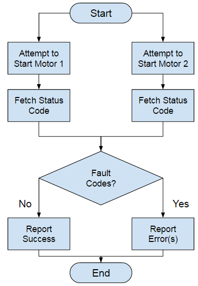

Parallel Processes and Flow Control​
SFCs work great when multiple processes must run simultaneously. Transitioning from one step to another only occurs when the active step finish executing. This means multiple steps can execute in parallel, and later steps will not begin until all of the currently active steps have finished. This type of control is normally very difficult to accomplish with just Timer or Tag Change scripts because each script needs to be able to notify the other script once complete. SFCs allow the chart to monitor each step, and determine when it is time to move forward.
Charts can also make use of local parameters. After reading values from outside the chart, these values can be stored in a parameter on the chart. The value of these parameters can then be referenced by other elements, and the chart can decide where the flow should move towards.
  • Start the chart.
  • Attempt to start both Motor 1 and Motor 2.
  • Check the Status Code from both motors. Pause all additional activity until a reponse code is retrieved from each motor.
  • If Fault Codes were returned, then Report the Errors, otherwise Report the Success.
  • End the chart.
