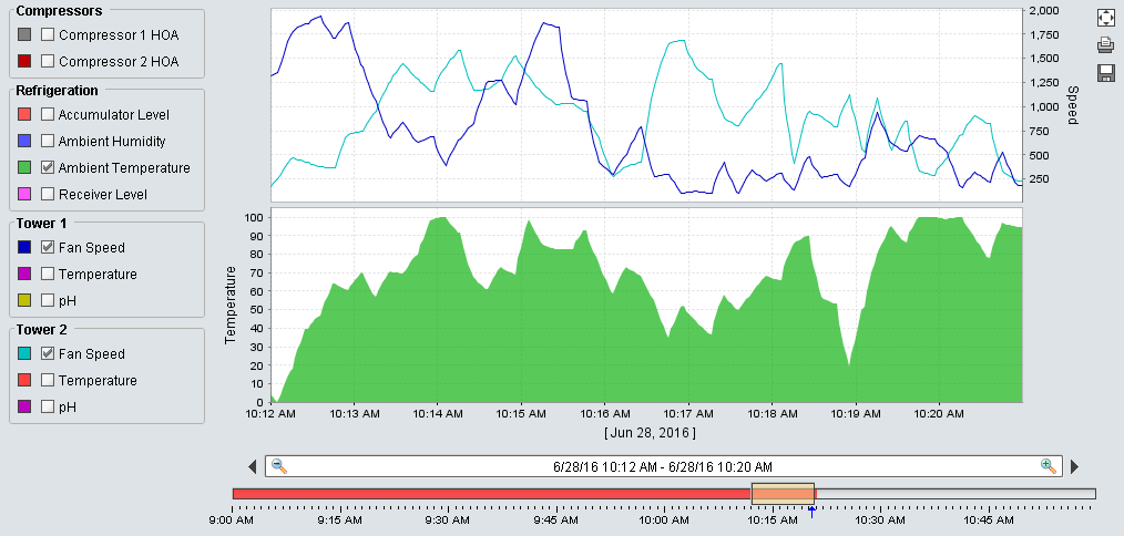

Displaying Data​
You can easily display information from your databases on a window along with anything else in Ignition. You can show parts lists, step sequences, realtime or historical charts, add the ability to search for inventory, or anything else you can think of.

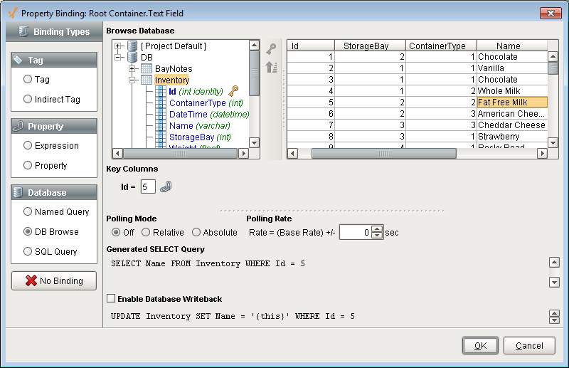

Queries in Bindings Ignition's binding system offers a lot of flexibility in how database data can be used in a binding. The Named Query binding allows you to select one of the Named Queries that were previously built for that project, offering a very secure method of pulling data from the database. The DB Browse builder provides an interface that will build the query based on the data in the table that was selected. This allows even users with little SQL knowledge to pull data from the database. Finally, the SQL Query option will accept a straight query, so that a query specific to that binding can be written directly in the binding. When binding to a basic (non-dataset) data type, you can use the Writeback feature directly to send any changes back to the database.

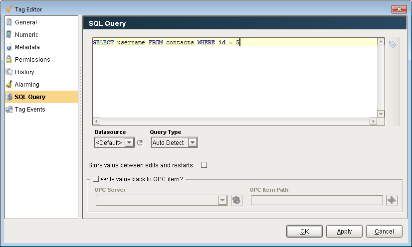

Queries in Tags​
Ignition offers Query Tags, which can run queries and return the result as a Tag value, giving all of the projects in the Gateway access to the same Database values.

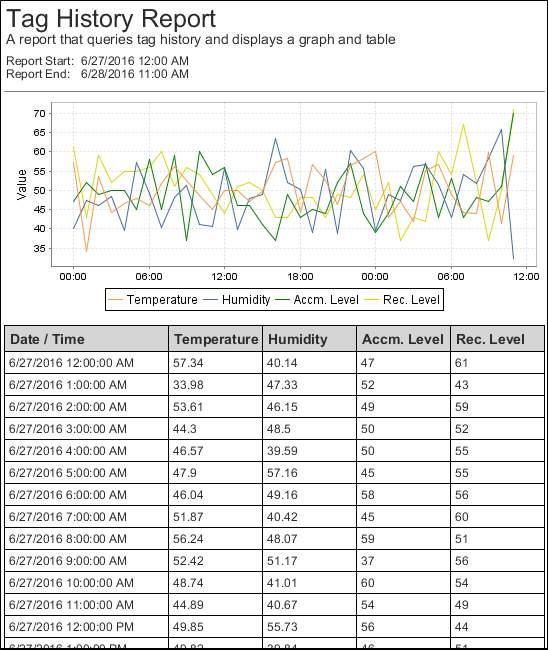

Queries in Reports​
You can leverage queries to access data from all database connections to create rich reports, from simple data logging to complex reports with grouped charts and datasets.

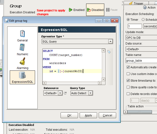

Queries in Transaction Groups​
While Transaction Groups are great at storing Tag data to a Database automatically, the built-in Expression Items can execute a SQL Query within the Transaction Group.

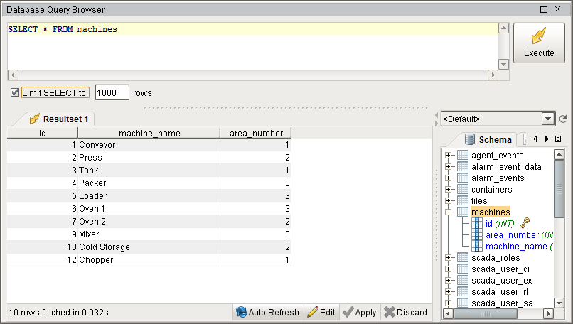

Database Query Browser​
The Database Query Browser offers an easy to use environment to run queries in for testing. Here, queries can be tested to figure out what values get returned, or data can be updated through raw queries, or the Database Query Browsers easy to use GUI editor.
