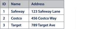

The foundation of every database system is a table. Every database consists of one or more tables, which store the database’s data/information. Each table is identified by a name (for example Customers or Orders), and consists of column definitions and rows of data.
The database table columns have their own unique names and have pre-defined data types. Table columns can have various attributes defining the column functionality (such as the primary key, index, default value, and so on).
While table columns describe the data types, the table rows contain the actual data for the columns.
