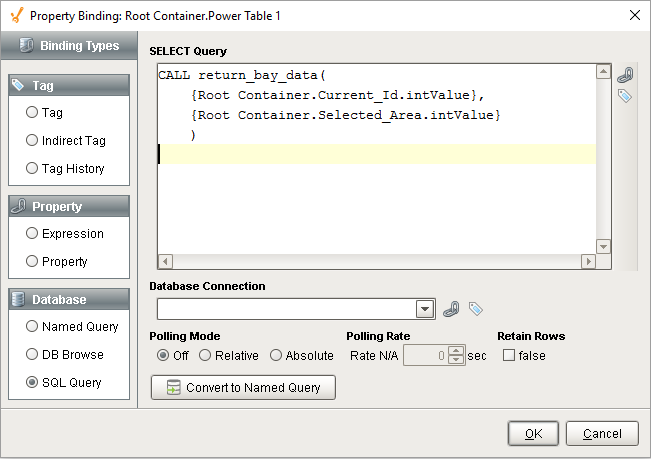

SQL Query Bindings​
Instead of typing a query directly into a SQL Query binding, a Stored Procedure may be executed instead. Assuming a MySQL database contains a Stored Procedure named 'return_all_bays', we can call the procedure on a binding with the following:
SQL - Calling a Stored Procedure in MySQL
CALL return_all_bays()
As with all bindings, Tag " " and Property " " references may be utilized by clicking the appropriate icons in the binding window.

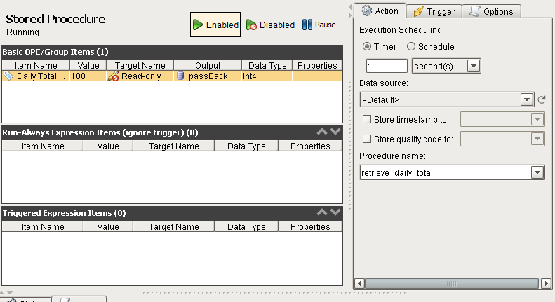

Stored Procedure Groups​
One of the easiest ways to utilize Tags with a Stored Procedure is to use the Stored Procedure Group. Parameters can be easily assigned to each item in the group, and utilize all of the features of a Transaction Group, such as scheduled execution and triggers.
Each item in the group is linked to a specific parameter in the Stored Procedure. Any IN or INOUT parameters can write directly to the Tags, while new values can be fed into OUT and INOUT parameters allowing you to easily move data from Tags into the database with the Stored Procedure.
