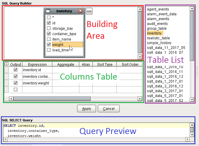

Once opened, the Query Builder has the following items:
  • Building Area: Visualizes the table relationships of all tables included in the query. Tables are typically dragged in from the Table List.
  • Columns Table: Shows which columns from all tables are referenced in the query.
  • Table List: Shows all database tables in the selected Database Connection.
  • Query Preview: Shows a preview of the query that will be created once the Apply button has been pressed.

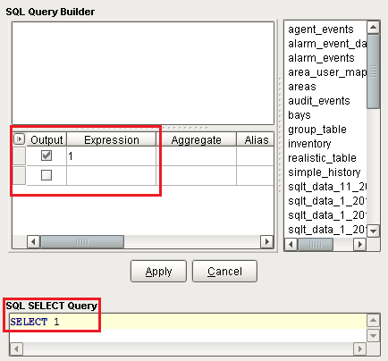

Clicking this button will open the Builder workspace with an empty query. If a query was already written before the button was pressed, then the Builder will attempt to load the query into the Builder's interface. For example, if the following query was typed before pressing the button:
SQL - Select Statement - Loading into the Builder's Workspace
SELECT 1
The following would be loaded into the Builder's workspace. Note that the Building Area is empty, because we're not querying from a table.
The Builder attempts to parse your query based on the Syntax Parser.

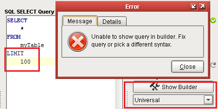

In MySQL, query results may be limited with the LIMIT keyword:
SQL - Limit Statement
SELECT
FROM
myTable
LIMIT
100
Attempting to open the Builder while using LIMIT, and the Syntax Parser is configured to a syntax that does recognize the LIMIT keyword, will result in an error:
In these scenarios, you can switch to a syntax that supports the query, or remove the offending lines.

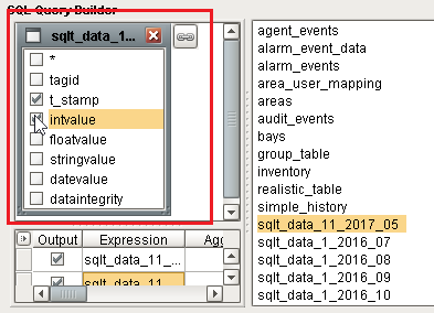

Once the Builder is open, (and if you have tables in your database connection), you can start building a query by dragging and dropping a table from the Table List into the Building Area. From here, you can select which columns on the Table Object you want to bring into the query, or drag and drop them into the Columns Table below.
The * option at the top of the table is special. If the * character is selected, then all columns from the table will be included in the results just like a "SELECT * " query.

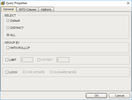

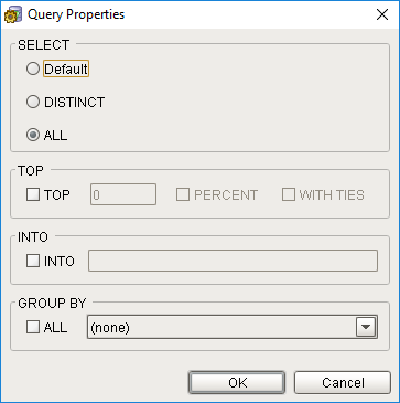

Right clicking on the empty space in the Building Area and selecting properties will bring up the Query Properties window that allows you to customize how the query works. How it looks and what it contains can vary, depending on what syntax parser you have selected.
MySQL Query PropertiesMSSQL Query PropertiesPostgreSQL Query Properties
