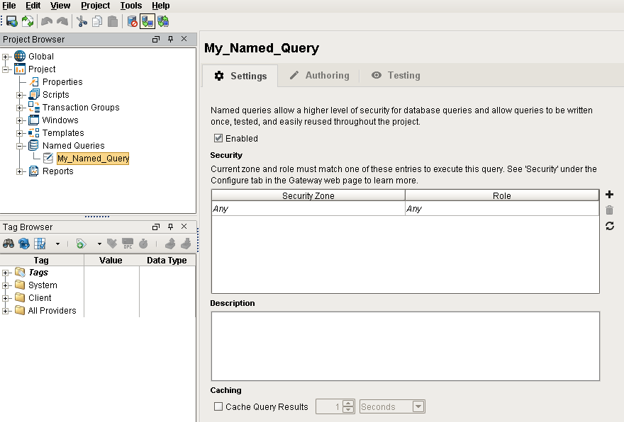

What are Named Queries?​
Named Queries are preconfigured queries that may be invoked elsewhere in a project. Named Queries are conceptually very similar to Project Scripts; defined in a single location, and then referenced in multiple places throughout the project. When executing a Named Query, parameters may be passed to return a dynamic result set. This way, a query may be written once, and then called from multiple locations throughout the project.
Named Queries have their own workspace in the Project section of the Designer.
Secure Query Execution​
While clients may request data from a Named Query, the actual execution of the query always takes place on the Gateway. Clients simply specify which query should run, and pass parameters that the Gateway will use. Additionally, the Gateway has an opportunity to restrict access to the query based on Security Zone and/or User Role. This provides a single interface to restrict access to the queries, and better protect your data. Additionally, queries cannot be modified by a Client other than by passing variables into it. This creates a very secure method to control what queries are being run against your database.

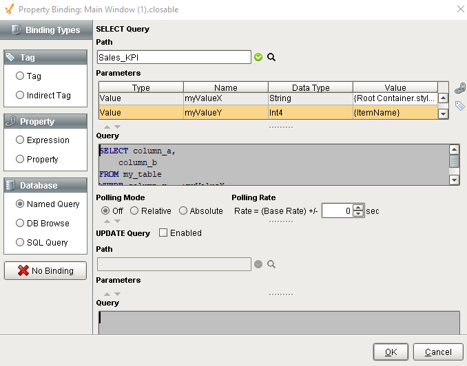

Bindings​
A Named Query binding type has been added to leverage named queries for any component property bindings. Parameters may be bound to Tags or other properties on the same window, allowing your users to modify the resulting dataset by manipulating other components similar to the original SQL Query binding type. You can also select and update a query to simulate a bi-directional binding to the database.

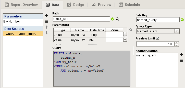

Reporting​
A Named Query Data Source has been added to Reports. Report Parameters may be used by the Named Query to generate dynamic reports.
