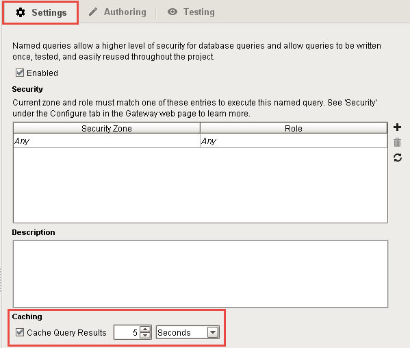

Named queries can opt-in to caching the results on the Gateway. This means if another request to the same Named Query comes in, the Gateway can return the cached result instead of having the database executing the query again. This will use more memory on the Gateway (to maintain the results), but could result in less queries running against the database.
Named Query caching is disabled by default, but can be enabled on the Settings section of each Named Query. If caching is enabled, the spinner and dropdown fields set the lifespan of the cache. Once the lifespan expires, the cache is invalidated. After the cache is invalidated, the next request for the Named Query will force the Gateway to re-execute the query and build a new cache.
Caching is especially useful for tables that are not updated often like recipe or inventory tables. Tables that update often like historical storage tables are bad candidates.
