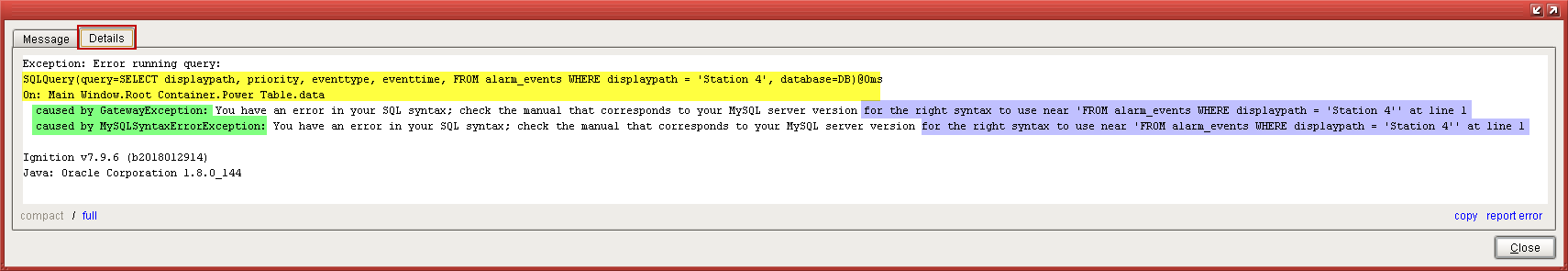

Error Message Box​
If a query fails to execute, chances are there was an error box that popped up. Resist the urge to close it! The Error Box usually contains a lot of useful info that can help troubleshoot why the query is failing. When looking at the error message, there are a few things to look for. First, you will want to click on the Details tab in the upper left corner of the Error Box. This will bring up the details of the error, which contains the information we need to track down the error.
In the image below, you can see the yellow highlighted part shows us what our query is, as well as where it is executing from. This helps to ensure we are looking at the correct error message for the query we are trying to fix. Next, you want to look for the words 'caused by' in the text of the error details, which tell us the reason for the error. You can see in the image below, there are two of 'caused by' messages highlighted in green.The first one is from the Gateway, and the second one is from the database (in this case, a MySQL database).
After locating the 'caused by', the following message will help to pinpoint what the error is. In this example, we have an error with our syntax in our SQL statement. The most helpful portion of the error is at the end of the message highlighted in purple. This lets us know where the syntax error is in the SQL statement. The trick is to look immediately before the quoted query. In the image below, it starts to quote the original query with 'FROM alarm_events WHERE.....', so in my original query, I need to look at what was right before the 'FROM'. You can see in my original query highlighted in yellow, there is a comma right before the 'FROM', which is incorrect, as the last column in the SELECT statement should not have a comma after it.

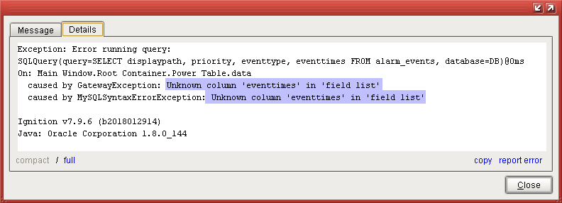

Unknown Column​
Typically, the name of the column is wrong because of a misspelling. In this case, the correct spelling was 'eventtime', but there was an accidental 's' added to the name.

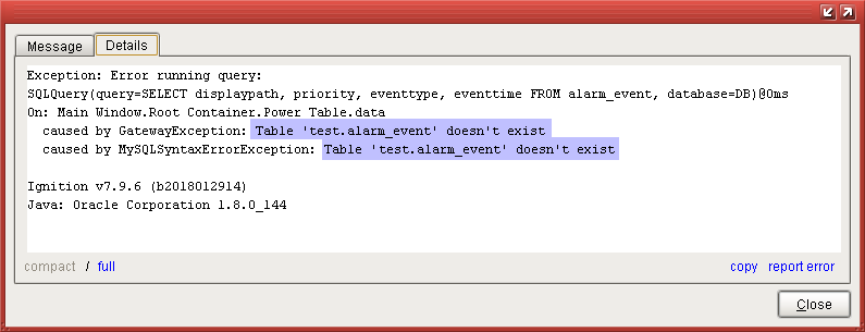

Unknown Table​
If the table is not found in the database, it may also be because of a misspelling. Here, the correct table name should be 'alarm_events'.

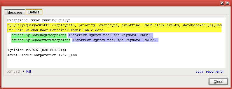

Any Database Error​
The previous error examples have all been from a MySQL database, but the same principles apply to any database. Simply locate the 'caused by', and look at the message afterwards. In this MSSQL syntax error, instead of displaying everything after the syntax error, it only displays the part immediately after. The problem in this query is an extra comma before the word 'FROM'.
