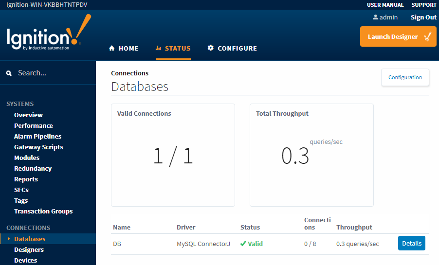

To provide context, you can always check the Status Section of the Gateway Webpage to check current throughput of each database connection.

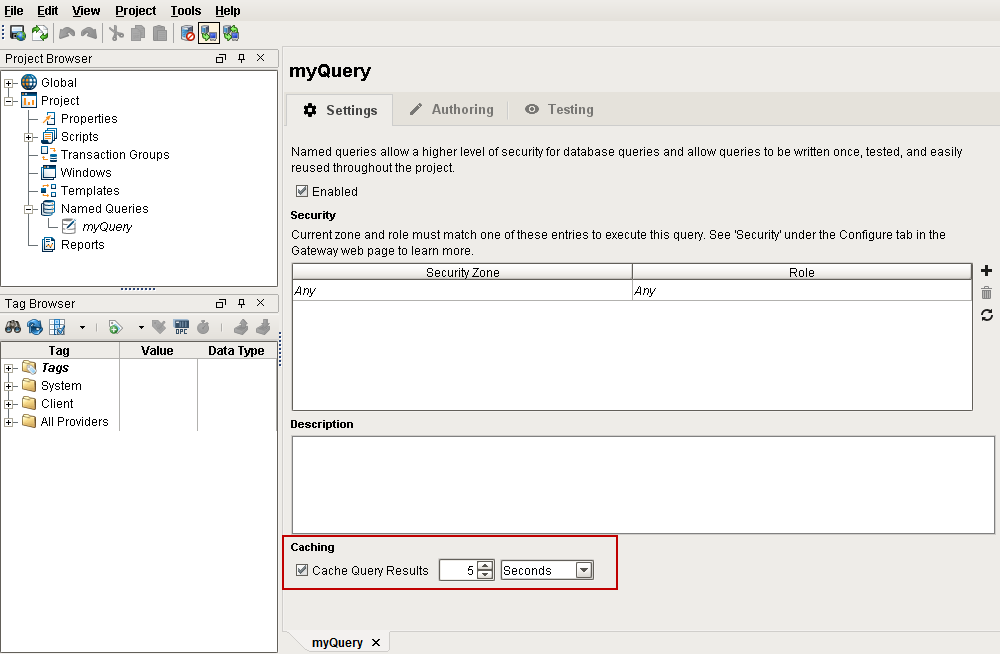

Most resources in Ignition that can request a query will not cache the results for use by other resources: a SQL Query Binding that returns a result set will only do so for the one component, and can't be utilized by other resources in the same project. Thus, if two clients have the same window, the same query must be fired twice for both bindings to receive information from the database which is wasteful.
Named Queries are the exception. They can cache the resulting dataset for use by other resources in the project, as well as other instances of the same project. In the previously mentioned scenario, one client would trigger the Named Query to execute, and the other client would simply utilize the cached result set, reducing the number of queries running against the database.
If your project contains queries that poll slowly, or results sets that aren't frequently modified, then a Named Query with caching enabled is an efficient alternative to a SQL Query or DB Browse binding.

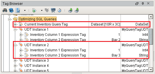

Below, the Tag named Current Inventory Query Tag, as the name implies, is a Query Tag retrieving multiple rows of data from a database table. We see that the highlighted UDT Instance 2 contains two members: Inventory Column 1 Expression Tag and Inventory Column 2 Expression Tag, which are simply Expression Tags that are referencing individual cells from the Current Inventory Query Tag.

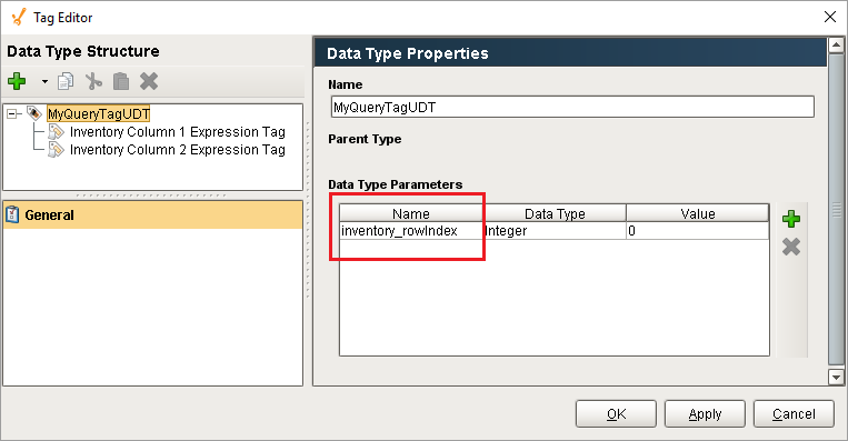

The UDT definition can use a parameter to specify an individual row in the Query Tag that each instance should focus on.

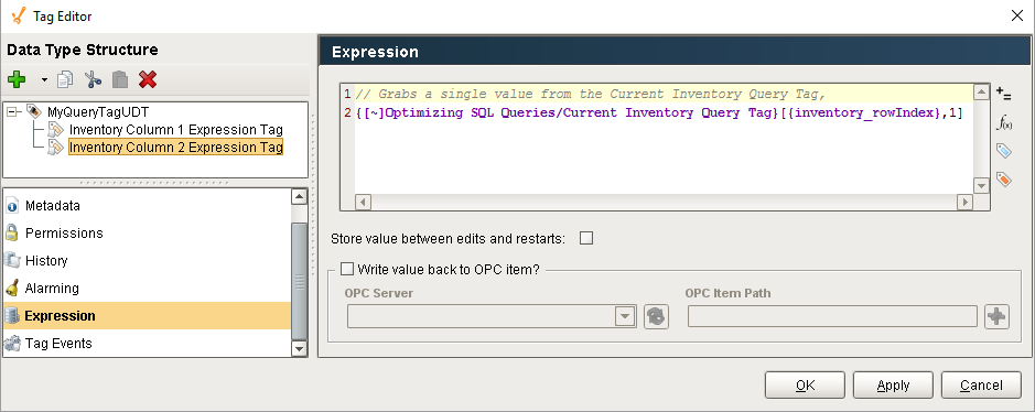

Each Expression Tag could use an expression like the following to look up individual values:

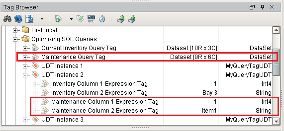

To add values from a separate database table, we simply need a separate Query Tag. In the image below, a new Tag named Maintenance Query Tag has been added, which is querying from a separate Database table. To incorporate this new data into our UDT instances, new Expression Tags have been added (Maintenance Column 1 Expression Tag, and Maintenance Column 2 Expression Tag) that simply reference specific values in the new Query Tag. Now, regardless of how many UDT instances exist in the Tag provider, we only have two Tags that are executing queries against the database.
For each separate table, we need to incorporate a single new Query Tag to collect all of the rows we want to show, add index parameters to the UDT definition, and add Expression Tags to our UDTs.
