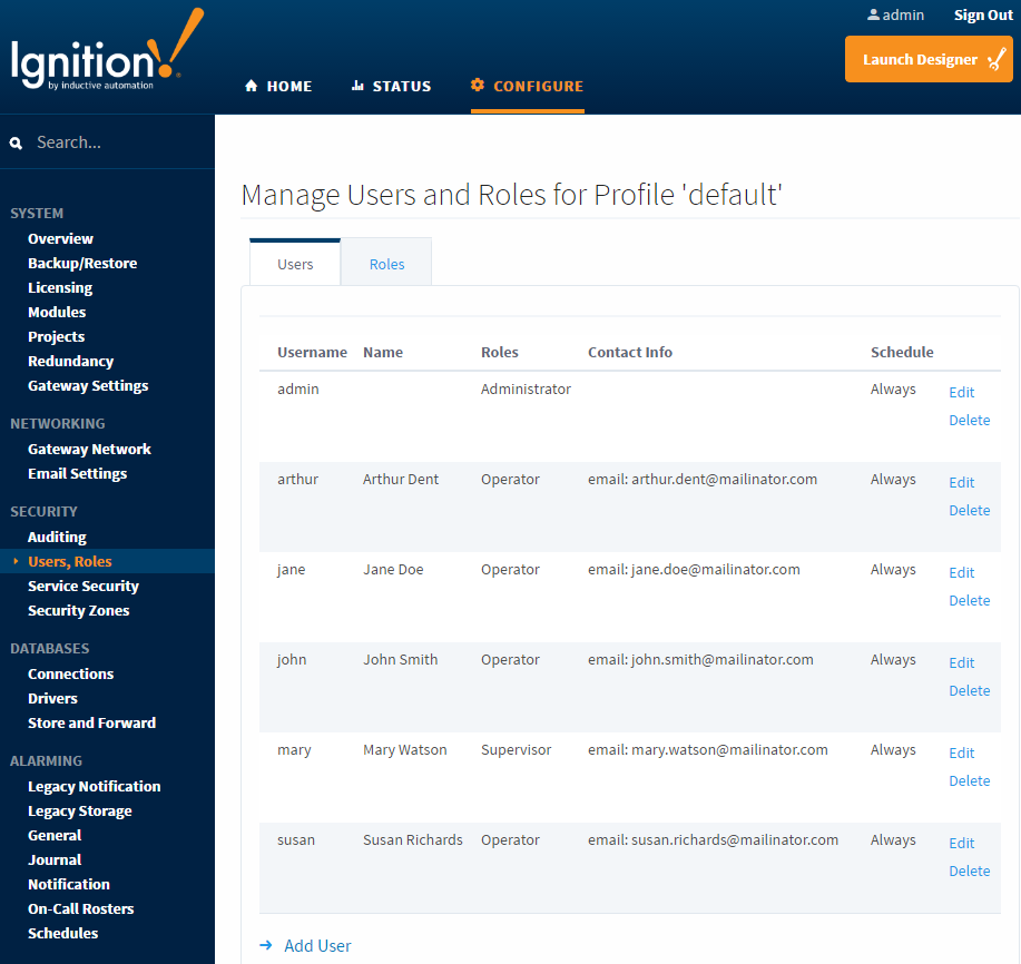

Users, Roles, and User Sources (Authentication)
Role-based security works under the concept that each user may be assigned to various roles. Security policies are then defined in terms of these roles, rather than defined for specific users. This allows users to be reassigned, removed, and added without affecting the logic of the security policy.
The users and their roles are stored in User Sources. An Ignition Gateway may have many different User Sources defined, each governing the security of different aspects of the Gateway. For example, logging into the Gateway might be governed by one User Source, while the security in a project is governed by another.
There are several types of User Sources that offer various features. For example, the Internal User Source offers the ultimate in ease-of-use: you simply define the users, their passwords, and the roles within the Ignition Gateway configuration web interface. In contrast, the Active-Directory User Source offers the power of integrating Ignition with a corporate security infrastructure. Users, passwords, and roles would be managed centrally by the IT department.
Contact Information and Schedules
User Sources are also used for other aspects of the system besides security. For example, the alarm notification system also takes user contact information to send alarm notification messages. A schedule can be defined for a user to control when they are able to log in, and when to receive alarm notification messages. Language preferences can be defined for each user to better support individual user's preferred language (Localization).

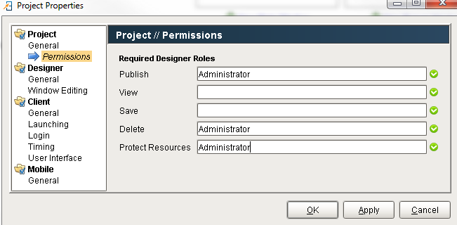

Project Based Access
Too many developers working on the same project could cause a number of problems: resource overlap, naming convention conflict, project creep, focus loss, and so on. To help with larger teams, Designer specific access levels can grant project permissions to certain roles. Actions such as Publishing, Deleting, or even Viewing the project in the designer can be restricted to certain roles.
Resources can also be protected, meaning that the window, template, or other resource should not be modified. This is a great way to flag an item as "complete" to the rest of the team, without having to manually document this information.

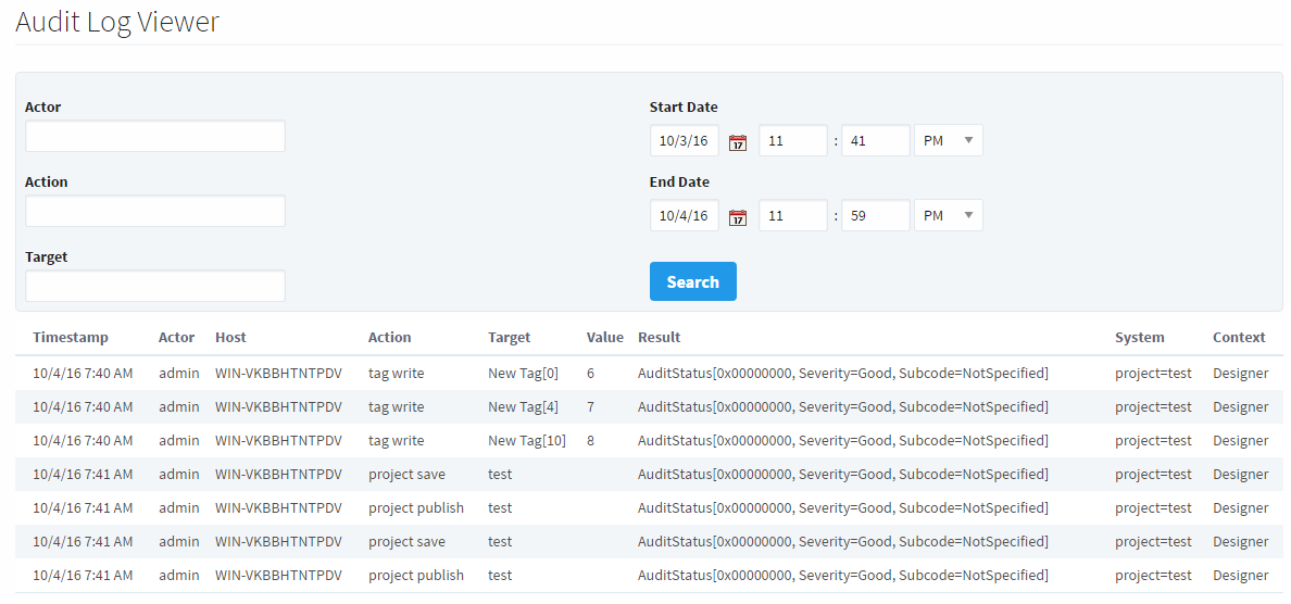

Auditing
Automatically record any changes that are made along with who did it, when it happened, and more. Auditing enables Ignition to record specific events to a SQL database. An Audit Profile can be used to record information for various systems in Ignition:
- Project Auditing: Record when users log in, log out, or write to any tags.
- Notification Profile Auditing: Record when a notification message would be sent. This reports who the notification was sent to, as well as if the attempt was successful or not.
Ignition provides a simple interface to view the Audit Log on the Gateway, and more.

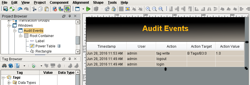

Since the activity is recorded into a SQL database, the data from the Audit Log can also be viewed by running a simple query. This way an "auditing" window can be added to any project, and allow any users (or users restricted to specific roles) the ability to view Activity recorded in the Audit Log. Even other systems can access the data in the Audit Log by querying the database!
