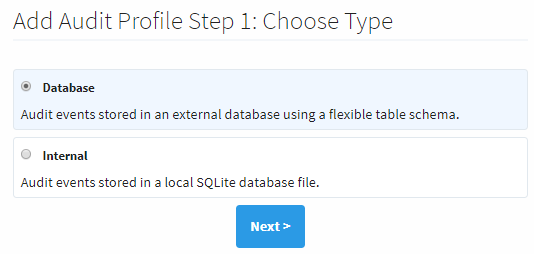

  4. Select Database or Internal audit profile type. This example uses the Database type, then click Next.

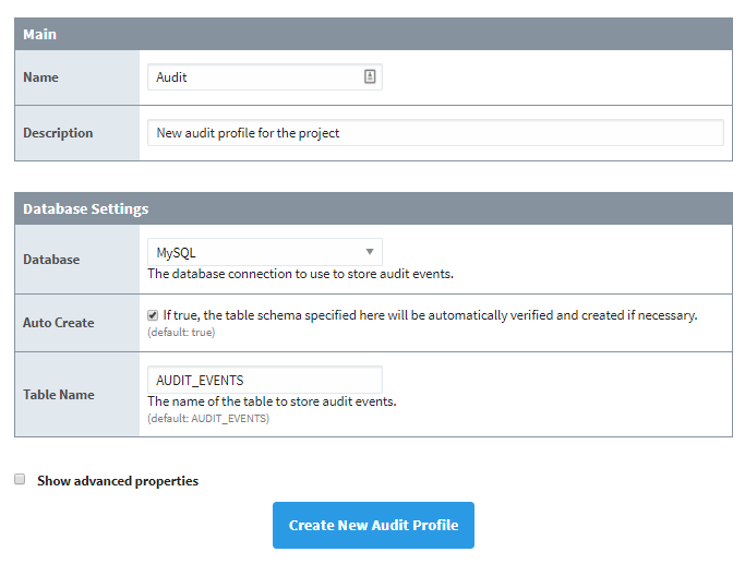

  1. Enter the Name of the audit log and Description (optional).
  2. Under the Database Settings, select the Database where the table will be stored, select the Auto Create check box, and enter the desired Table Name.
  3. Click Create New Audit Profile.

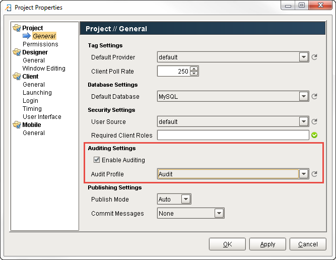

  1. Go to the Designer, open the project that you want to enable auditing on, and go to Project > Properties.
  2. Go to the General section, select the Enable Auditing check box, and select your Audit Profile from the drop-down menu. The audit profile is used to record audit actions for your project. If the new audit profile does not show up, click Refresh.
  3. Click OK.
  4. Save your Project.

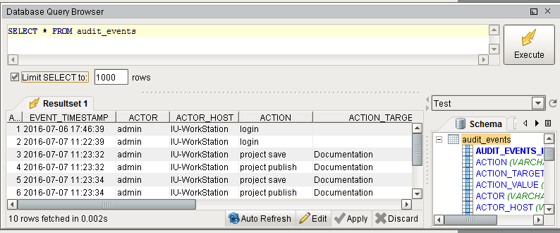

There are a few ways to view audit information: using a Table component, interface on the Gateway, or the Database Query Browser. Here is one example of viewing an Audit Log using the Database Query Browser.
  1. Go to Tools > Database Query Browser.
  2. Under the Schema area, double click on a table, and it will expand the query in the Database Query Browser area.
  3. Click Execute, and all the audit log data will be displayed in the Resultset1 area.
Refer to the Database Query Browser to learn more about how it works.

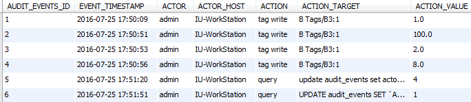

Audit Table Definition​
The following table describes the audit table as it exist in the database:
Column NameDescription
AUDIT_EVENTS_IDThe id of the row.
ACTIONBrief description of the action.
ACTION_TARGETThe target of the action.
ACTION_VALUEThe value acted upon the action target.
ACTORThe logged in user when the action occurred or a description of the system that generated the action.
ACTOR_HOSTThe host computer where the action occurred.
EVENT_TIMESTAMPThe time when the action occurred.
ORIGINATING_CONTEXTA numerical description of the origin of the originating system. gateway = 1, designer = 2, client = 4
ORIGINATING_SYSTEMThe name of the project or system where this action occurred.
STATUS_CODEA 32 bit integer that represents a bitmask of severity (good, bad, uncertain). The bitmask represents the status of the action recorded. For example, a tag write failing would result in a "bad".
