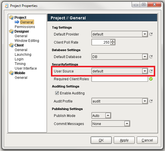

Projects are assigned a User Source to authenticate against. All roles that have been defined in the User Source can be referenced in the client to block or allow access. Once roles have been created, you can easily start assigning component-specific security settings in the Designer.

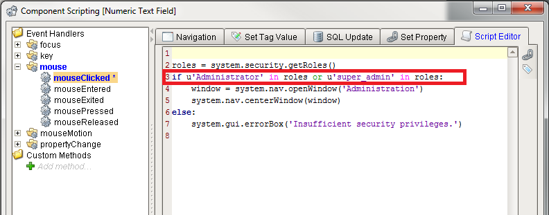

The component-based security settings are fairly simplistic: the user either has the required roles, or a restriction applied. In situations where consideration for access should go beyond a simple role check, security-based scripting can provide a larger degree of granularity. Information about the logged-in user, such as user-name or roles, can be detected by scripting, allowing for the creation of a robust security system.
More information can be found on the Security in Scripting page.
