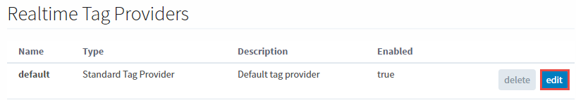

  2. Choose Tags > Realtime from the menu on the left. The Realtime Tag Providers page is displayed.
  3. Click edit to modify the realtime Tag Provider that you want to apply the roles to.

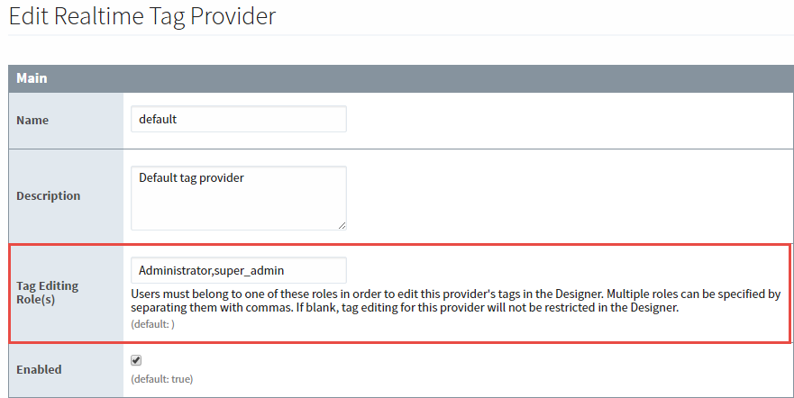

  4. In the Tag Editing Roles property, enter the roles that you want to grant permission to edit Tags. By entering roles, you block users without one of these roles from editing Tags in the Designer.
  5. Click on Save Changes.
