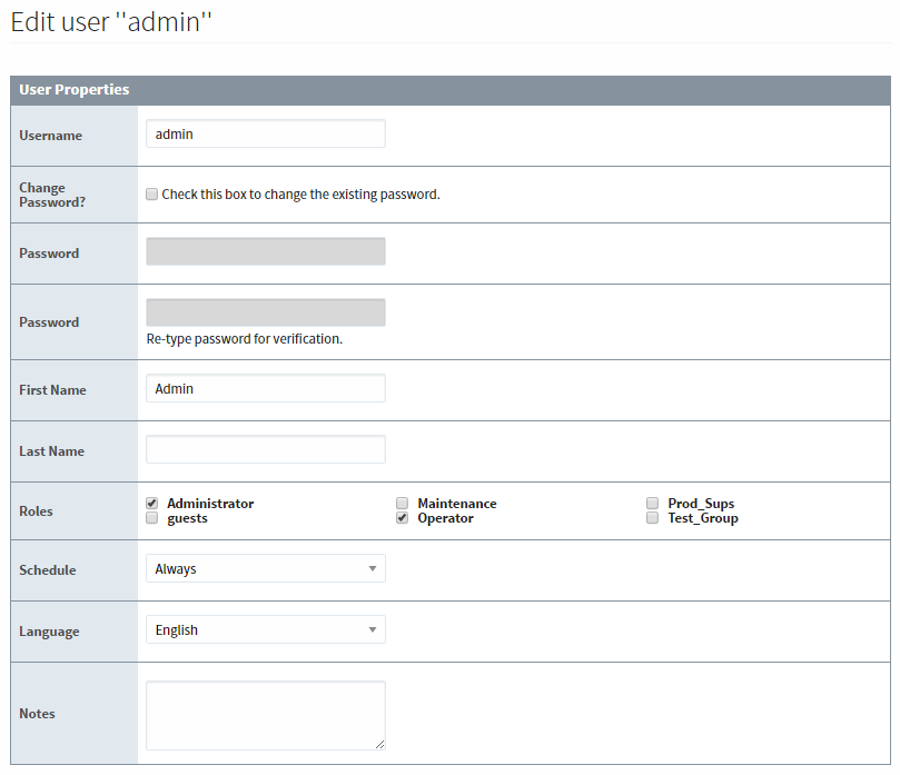

The 'default' User Source​
When Ignition is installed for the first time, an internal User Source named 'default' is created. This User Source contains the 'admin' user, and the Gateway uses this User Source as the system user source, so that users can initially log into the Gateway. You can manage the default User Source by navigating to the Configure > Security > Users, Roles section of the Gateway. The manage users link will allow you to add new users, modify roles and passwords for existing users, remove users, and add/remove roles from the user source. Choosing to edit a user will bring you to the following page allowing you to make any necessary changes to that user.
tip
The 'admin' user
After installing Ignition, it is highly recommended to change the password for the admin user. The default user credentials to access the Gateway are public knowledge, and not fit for a production environment.
Alternatively, the admin user could be deleted, but a new user with the 'Administrator' role should be created first so that you will not be locked out of the Gateway. Should this occur, the Gateway Control Utility can be used to recreate the admin user.
