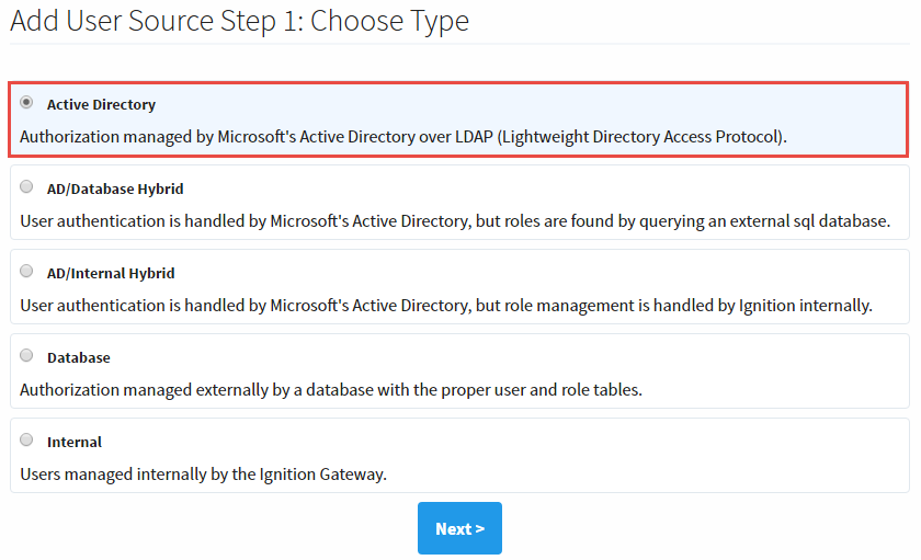

  1. On the Gateway Webpage, under the Configure section, go to Security > Users, Roles.
    The User Sources page will be displayed. Click the blue arrow, Create new User Source.
  2. Choose the Active Directory authentication type, and click Next.

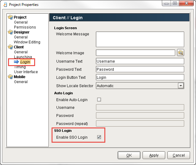

  4. If you plan on using Single-Sign-On, then you will need to enable the SSO Enabled property, and continue on to the next step. In either case, click the Create New User Source button to create the User Source.
  5. If you plan on using Single-Sign-On, you need to enable it per project by modifying the project's settings: in the Designer under Project > Properties. Under Client > Login, mark the checkbox for Enable SSO Login. Click OK.
Enable Single-Sign-On (SSO)
SSO is enabled on a per project basis. You have to configure it in the Active Directory authentication profile, and enable it for each project you want to use SSO with.
