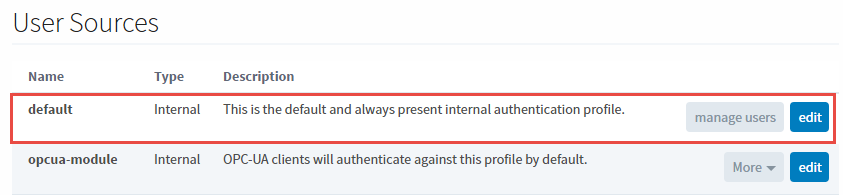

Internal User Sources​
An Internal type User Source stores user information internally in the Gateway's database. This means that Internal User Sources are included in Gateway Backup files, and don't require an external SQL database, or other external user management system.
When Ignition is first installed, the "default" User Source that initially grants access to the Gateway and Design is an Internal type User Source. You can, of course, continue to use this 'default' internal User Source for your project(s), or you may choose to use other User Sources instead.
The Internal User Source is fully manageable from within Ignition. You can access User Sources from the Gateway webpage under the Configure section, Security > User, Roles, and click the edit button.

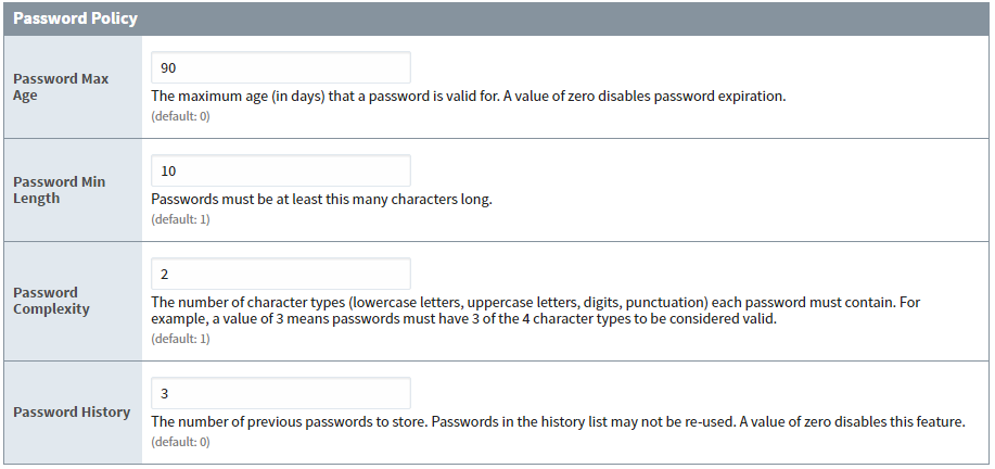

Password Policies Properties​
The Internal User Source has password policies that are configurable from within the Gateway to provide an extra layer of security by ensuring that good password practices are used. You can change the default password policies by entering the appropriate password values to support your password policies. Below is a description of the Password Policy properties.
NameDescription
Password Maximum AgeThe maximum age in days that the password will still be valid. After the number of days has past, when the user tries to login, it will prompt them to change their password. A value of 0 will disable this feature.
Password Minimum LengthThe minimum amount of characters that a password must contain to be considered valid. If the user tries to make a shorter password, it will not allow it, and let them know that it does not meet the minimum length requirements.
Password ComplexityThis determines how complex a password must be. There are four character types: lowercase letter, uppercase letter, digits, and special characters. The value here determines how many of those character types must be present at least once in the password for it to be considered valid.
Password HistoryDetermines the number of previously used passwords to store. When users make a new password, old passwords can not be re-used. A value of zero disables this functionality. History is only stored while this setting is turned on, so any passwords used while this is off can be re-used when history is turned back on.
