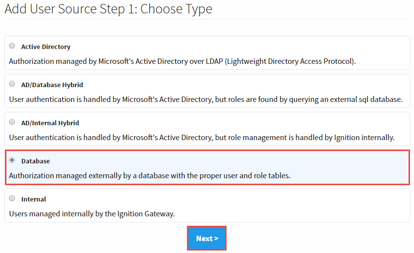

  1. On the Gateway webpage under the Configure section, go Security > Users, Roles. The User Sources page will be displayed. Click the blue arrow, Create new User Source.
  2. Choose the Database authentication type, and click Next.

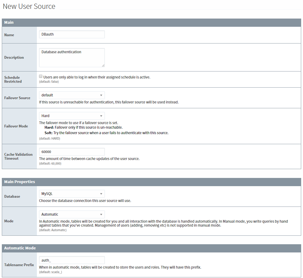

  3. The New User Source window will open. Some properties are optional, but if you're using Automatic mode, enter the following properties as appropriate.
    • Name: DBAuth - name of the user source.
    • Failover Source: default - failover user source ('default' is the internal user source).
    • Failover Mode: Hard - if the source is unreachable, then use the failover source. (Can choose the Hard or Soft option).
    • Database: MySQL - external database.
    • Mode: Automatic - tables in the external database will be automatically created when needed.
    • Tablename Prefix: 'auth_' is the prefix for all the tables that get created. (You can leave this field blank, but if you use a prefix when the tables get created, they will contain the specified prefix in their name).
    • When finished, click Create New User Source.

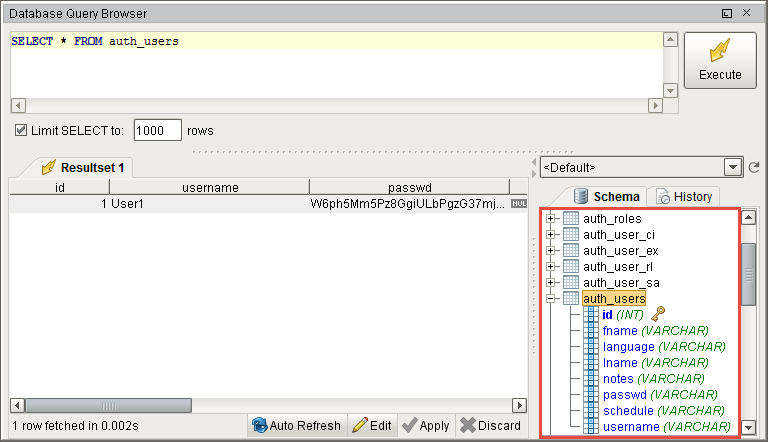

  4. Now that your Authentication profile is created, add a user. On the right, click on the More > Manage Users link. Click on the Add User link and fill in the required fields.
  5. Now that your tables are created we can verify them. To view the tables, go into Designer and from the menu bar, select Tools in the menubar, then Database Query Browser. You will see all the tables that were created beginning with 'auth_' when the user and role get created.
  6. Double click on any of tables beginning with 'auth_', and click Execute. In this example, you will see the tables associated with 'roles' and 'users' displayed in the Schema area.
