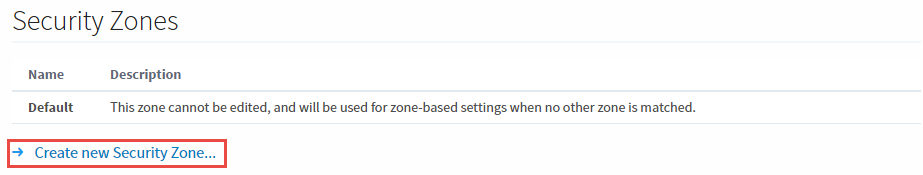

Security Zones are defined in the Configure section of the Gateway webpage by going to Security > Security Zones.
note
There is a special zone called Default. It is always present and can't be modified, and will be used if an incoming connection does not match any of the other defined zones.
Selecting the Create new Security Zone link brings up a new page where the Security Zone can be defined.

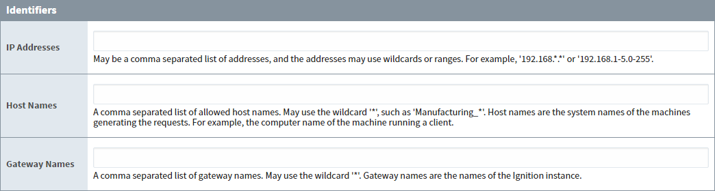

Identifiers​
The identifiers are how incoming connections are distinguished between different zones. While there are a few different ways to define the incoming connection, it only needs to match one of them to match this zone.
  • IP Addresses - This defines an IP address that the connection is coming from. This can be a list of IP addresses by using commas to separate them. It can also make use of the () wildcard like '192.168.100.', or use a range such as '100.100.1-100.0-255'. With IP addresses, virtually all connections can be listed. Use 127.0.0.1 for the local connection.
  • Host Names - The host name refers to the system name of the machine generating the request such as Joe_Workstation. This can be a list of names separated by commas, and it can also use the () wildcard like '_Workstation'.
  • Gateway Names - The Gateway name is the name of the Ignition instance. This is set in the Configure section by going to System > Gateway Settings, and changing the System Name. This can be a comma separated list and can use the wildcard such as '* Ignition Gateway'.
Many incoming connections can be defined using any of the three identifiers, or even multiple at once. As mentioned before, an incoming connection only needs to match one of the identifiers for it to be accepted.
caution
When identifying a Gateway through a proxy Gateway, the IP Address should be using the ip of the proxy, but the Gateway Name should use the name of the Gateway we are trying to identify.

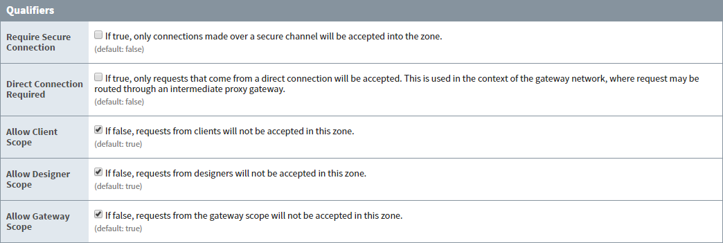

Qualifiers​
After first being identified as part of a particular Security Zone, the connection then must check the Qualifiers. With the Qualifiers, the incoming connection needs to fit in with all of the properties before it is fully placed into the Security Zone.
  • Require Secure Connection - If this is true, only connections that are made over a secure channel will be accepted.
danger
A Security Zone is only able to check connections made to the gateway the zone is defined on. This means that connections through a proxy Gateway may not be secure.
  • Direct Connection Required - If this is true, only connections that come from a direct connection will be accepted. The Gateway Network allows you to connect three Gateways in a 1-2-3 configuration, where Gateway 1 can see Gateway 3 through the proxy Gateway 2.
  • Allow Client Scope - If this is false, Clients will not be placed in the zone.
  • Allow Designer Scope - If this is false, Designers will not be placed in the zone.
  • Allow Gateway Scope - If this is false, any Gateway scoped requests will not be placed in the zone.
As mentioned above, a connection must pass all of the qualifier checks before being accepted into a Security Zone. So if Require Secure Connection was checked, and Allow Client Scope was not, any requests coming from Clients would be rejected even if they are secure, and the same goes for any non-secure connections coming from sources other than a Client.

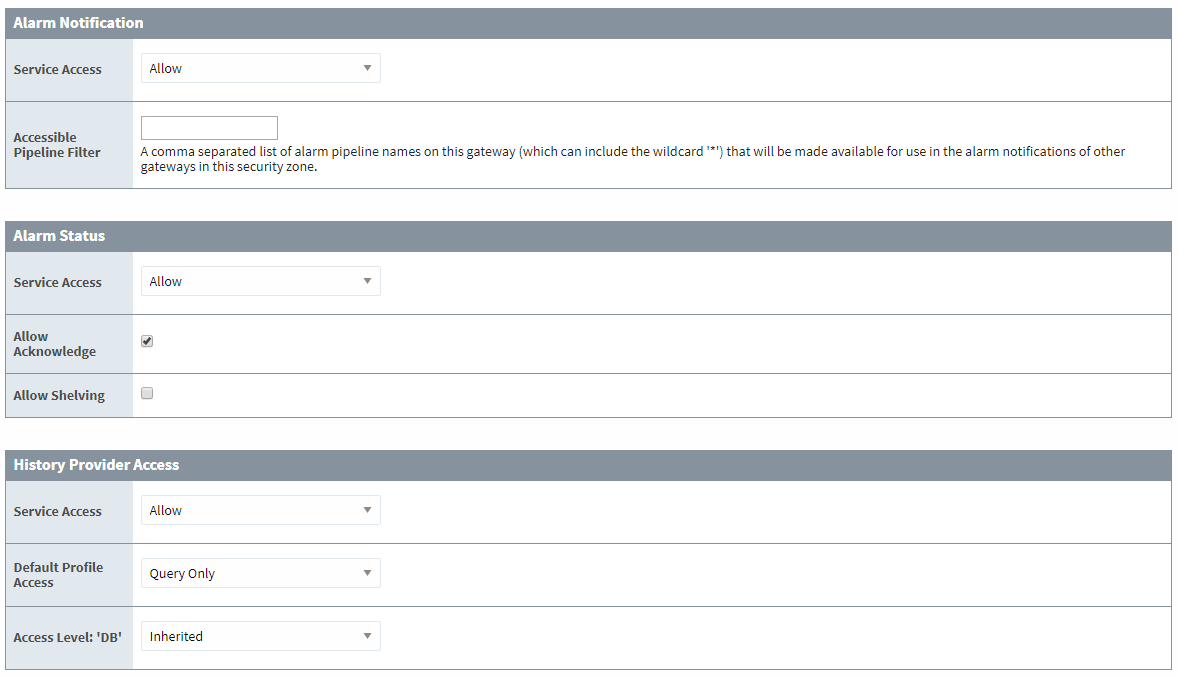

After creating some Security Zones, a Security Policy can then be defined for each zone. This can be found by going to the Configure section and navigating to Security > Service Security. At first, none of the zones will have a policy defined, and the Default zone will be at the top. Editing any of them will bring up the Security Policy definition page for that zone. The Security Policy has four sections: Alarm Notification, Alarm Status, History Provider Access, and Tag Access. They work together to define how the local Gateway gives access to incoming Gateway connections. All four sections also have the ability to completely block access to specific services with the Service Access setting in each section. Setting that to deny will deny the zone access to that particular information, regardless of what the rest of the options are set to.
caution
It is important to realize that if you have a single Gateway, limiting access of certain clients to certain Tags is still done in the individual Tags.
  • Alarm Notification - The Accessible Pipeline Filter setting is a list of Pipelines in the current Gateway that other connections can use for alarm notification. Note that this setting is an inclusionary list not an exclusionary list, meaning that if there are no pipelines listed there, then all of them will be available. The list is a comma separated list, and it can make use of the (*) wildcard.
  • Alarm Status - The Allow Acknowledge setting will allow the Gateways that fall within the zone to acknowledge alarms on the local Gateway.
    New in 7.9.7
    The Allow Shelving setting will allow the Gateways that fall within the zone to Shelve alarms on the local Gateway. IE: Other Gateways can shelve alarms on this Gateway. For this Gateway to shelve alarms on others, this must be set on the remote Gateway.
  • History Provider Access - The History Provider Access has two different settings. First, it has a Default Access Profile. This is the default access rights for Tag History. Second, there will be a setting for each History Provider setup on the local Gateway. In the picture below, there is an "Access Level: 'New Connection" that can be set that corresponds to the History Provider that was created when a database was connected. It can be set to Query and Storage, which will allow connections in the current zone to both run queries and store Tag History against the Tag History provider, Query Only, which will only allow the zone to query out history data, but not store it, and No Access, which will completely block access to that History Provider. The final setting is Inherited, which will inherit the Default Profile Access rights. Any new history providers will automatically get added to the security policy set at inherited so it may be beneficial to set the Default Profile Access to be either Read Only or No Access so that a recently added history provider does not accidentally get storage rights when it should not.

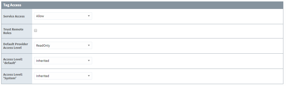

  • Tag Access - The Tag Access also has a few different settings. The Default Provider Access Level, which works the same as the History Provider Default Access Profile. It sets the default access rights for realtime providers. It will then have a setting for each provider configured in the local Gateway, as well as an additional one for system Tags. These can be set to ReadWriteEdit, which will allow connections in the current zone to read, write to, and edit the Tags in that provider, ReadWrite, which allows the zone to read and write to Tags, and ReadOnly, which only allows the zone to read the Tags. It also can be set to None, which will prevent the zone from interacting with the Tag Provider altogether, and Inherited, which will again inherit the access rights set in the Default Provider Access Level. Any new Tag Providers will automatically get added to the security policy with Inherited access rights.
    New in 7.9.1
    The Trust Remote Roles setting will allow similarly named roles on other Gateways to access Tags with role specific security on them.

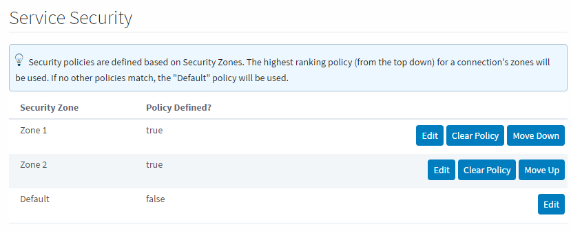

Setting Zone Priority​
Once a security policy has been defined for two or more zones, a new option appears on the Service Security page to move the zones up and down the list. This allows a priority to be set on the Security Zones, since a connection can apply to multiple zones. For example, say Zone 2 dictates that all requests coming from a range of IP addresses have query only history access, and read write access to Tags. Zone 1 includes specific Gateways, one of which is also contained in Zone 2, that will have query and storage history access and read write edit access to Tags. When a request comes in from a connection, it first determines which Security Zones it belongs to. The request then starts at the top of the Service Security list and goes down until it finds the first zone that it is in, and uses the access rights of that zone. In our example, we want to make sure Zone 1 is above Zone 2, so that the Gateway that is in both Zone 1 and Zone 2 gets the full access rights afforded to it by the security policy of Zone 1 instead of getting the limited access rights from Zone 2.
