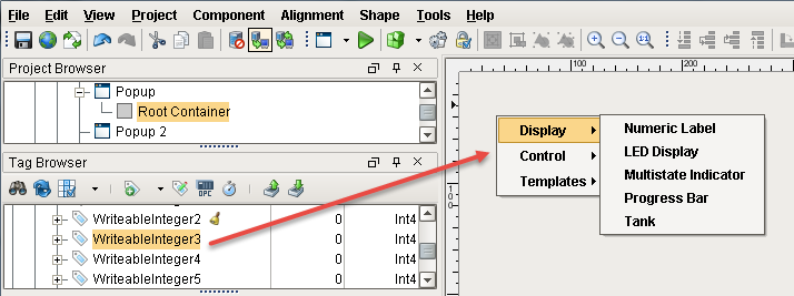

  • Drag and Drop Screen Design
    Using the Vision module, you can drag and drop tags to a window to automatically create new bound components. Drag tags to existing components or properties to quickly bind them to the data. Creating powerful status and control screens is literally just clicks away.

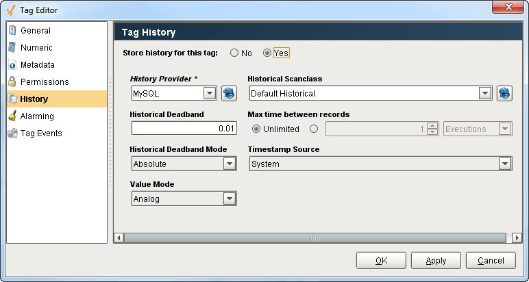

  • Historical Logging
    Tags Historian™ makes it easier than ever to store and use historical data. When you simply select a check box on a tag, historical data is stored in an efficient format in your SQL database. This data is then available for querying through scripting, historical bindings, and reporting. Also, you can drag-and-drop tags directly onto an Easy Chart to create trends or onto a table to display historical values. Tags Historian's robust querying provides you great flexibility in how you retrieve the data.

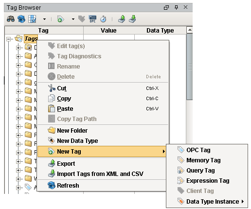

  • Creating Tags Manually
    The above method only works for OPC tags, and then only for browsable tags. For other types of tags, as well as OPC tags that cannot be obtained through browsing, you can create Tags manually in the Tag Browser. Click on the New Tag icon or right-click on the provider node and select New Tag.

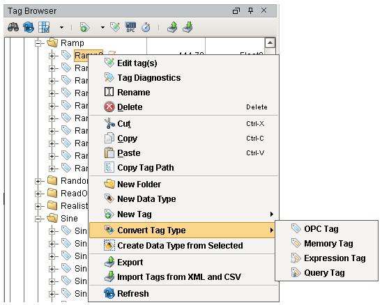

  • Converting Tag Types
    Once created, it is possible to convert a tag to a different type – such as from OPC to Expression. To do this, right-click on the tag, and select Convert Tag Type.

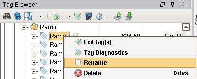

Re-naming Tags​
Tags can be named anything (inside the rules of allowed characters). In other words, it is not necessary that tag's name be related at all to its underlying data source (opc path, for instance). This provides a level of indirection that is convenient for systems whose underlying data storage changes, is based on tag codes (N7, F8, etc.), or for system with many repeat tag structures. By providing tags with meaningful names and arranging them in hierarchical folders, indirect binding can be used to create robust screens that can be used for multiple systems.
See Keeping Tags Organized for more information about renaming and setting up Tag structures.

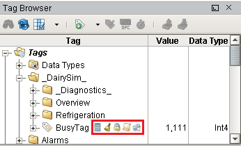

Tag Icons​
Certain settings or tag configurations are visually represented next to the tag in the Tag Browser.
This icons simply allow you to note some important settings on the tag at a glance. A description of the icons are listed below.
IconSettingDescription
" "ScalingThe Scale Mode property under the Numeric section of the Tag Editor has been set to a value other than None. The value on the tag will be scaled to some degree.
" "AlarmingAt least one alarm has been configured on this tag.
" "Custom Access RightsThe Access Rights property has been set to Custom. Some users or security zones may be unable to read from or write to this Tag due to the security settings.
" "Tag HistoryThis tag has been configured to log data into the Tag Historian system.
" "Tag Event ScriptAt least one Tag Event Script has been enabled on this Tag.
