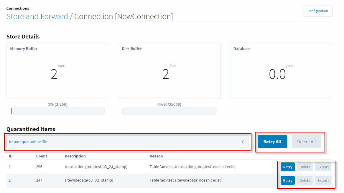

To Handle the Quarantined Data​
  1. From Status section of the Gateway, go to Connections > Store and Forward.
  2. Click the details tab next to a Store and Forward engine that you would like to see the quarantine data for. Here you will see any quarantined data which are listed according to the order they got quarantined. Each set of data has the option to retry it, delete it, or export it for later use. If there are a lot of quarantined records, it may be a good idea to export and delete them so that the store and forward engine won't fill up and drop records.
  3. Fix the problem/error you found that caused the quarantine data.
  4. Click on retry, or if the data had been exported, import the data using the import tool and then retry. This way, you can ensure no data gets lost.
