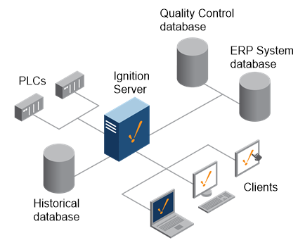

Where to Install a Database​
You can install your database anywhere that Ignition has access to through the network. There are two main options for installing your database: one is on the computer that Ignition is installed on, and the other is installed on a different server in your network. Technically there is a third option to connect Ignition to a database that is in a remote location using a VPN or some other way to access it. This third option will work, but because of latency and the data being physically very far away, it is not recommended for storing data that will be accessed often like Tag History.
For production systems, we recommend that your database is on it's own server, not installed on the computer with Ignition. This is helpful for many reasons, but mostly because databases can potentially take up a lot of resources on a computer. If the database is on it's own computer, you don't have to worry about other programs starving for memory or CPU. If you do this and install your database on another computer, just make sure to adjust your firewalls and pay attention to the database connection security. Most databases don't allow the default username to connect remotely.
