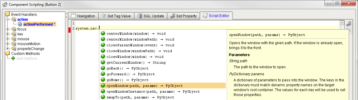

Luckily, Python is a simple language to get started with, and using it in an event-driven system takes away a lot of the extra code that normally makes programming time consuming. For those that are already familiar with scripting (and those of you that are learning), we also have a huge list of functions inside Ignition to do some of the common tasks in a single line of code. These System Functions are available while typing. Just start with system and press ctrl-space to see a list of available functions. The list will filter itself as you continue typing.

The majority of your scripting will be done in Event Handlers inside of components. This system makes it very easy to get started scripting with little to no experience. With the four script builders, basic scripting like Navigation and setting Tag values takes just a few clicks!
