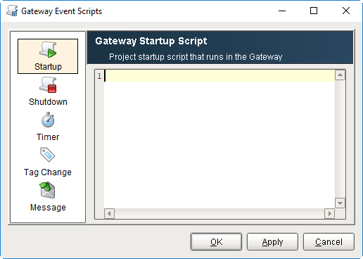

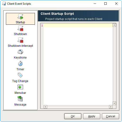

The Startup Script event runs at the startup of either the Client or the Gateway. This allows you to run a script at startup, giving you the chance to configure certain things dynamically.
Gateway Startup Behavior​
In the Gateway scripting scope, this means that the script will run when the Gateway starts up and whenever the scripting configuration changes via a Designer save action. This means that while designing, the startup and shutdown events may happen frequently.
There is a specific order to when the various startup scripts are run. When troubleshooting your Gateway startup times, consider the following:
  1. Gateway starts - The Gateway will start as an OS service, and start the context. No startup scripts can run before this is complete.
  2. Projects are started - This includes all of the Gateway scoped items in the projects such as Transaction Groups, SFCs, etc. This does not refer to launching clients, and no clients can be automatically launched at this time. All Gateway Startup Scripts are run at this time for each project. Note: if you copied a project, always check for Gateway scoped events such as these. You generally don't want a Gateway Startup Script to run twice because it is in two projects.
Client Startup Behavior​
In the Client scripting scope, Client Event Startup scripts run after a user successfully logs in to the client, but before any "Open on Startup" windows are opened. Client Event Scripts can be used to open up a custom set of windows based on who logged in.

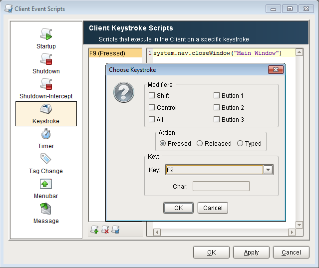

Keystroke Scripts​
Inductive University
Keystroke Scripts
Watch the video
Client Keystroke Behavior (Not Available in Gateway Scripts)​
The Keystroke Scripts let you create different events that will activate on certain key combinations. They only run in the Client, but you may add as many Keystroke Script events as you'd like, as long as each one has a unique key combination.
Since multiple Keystroke Scripts can be added, there are separate buttons that allow you to add () a Keystroke Script, or edit () and delete () the currently selected Keystroke Script.
When choosing a keystroke, you may choose any number of modifiers, which are keys or mouse buttons that must be down to activate the keystroke. You can also choose whether or not the keystroke is on the pressed or released event of a keyboard key, or upon the typing of a character. Special keys like the Function keys (F1) or ESC key are only available in the pressed and released actions. The example below shows the F9 key when pressed, closes the window called "Main Window."
caution
Some Operating Systems reserve certain keys for certain function, and will capture the key press or release before it gets sent to the Client. For example, many Operating Systems use the TAB key to shift focus to the next field.

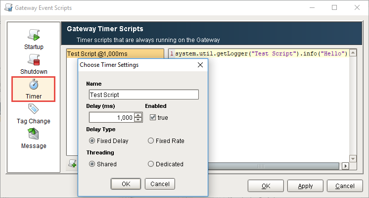

The Timer Scripts execute periodically on a timer at a fixed delay or rate. This allows you to set up a sort of heartbeat that can run in the Client or the Gateway Scope. Since multiple Timer Scripts can be added, there are separate buttons that allow you to add () a Timer Script, or edit () and delete () the currently selected Timer Script. The Timer Script has three major settings: Delay in milliseconds, Delay Type, and Threading.
A Fixed Delay timer script (the default) waits for the given Delay between each script invocation. This means that the script's rate will actually be the delay plus the amount of time it takes to execute the script. This is the safest option since it prevents a script from mistakenly running continuously because it takes longer to execute the script than the delay.
Fixed Rate scripts attempt to run the script at a fixed rate relative to the first execution. If the script takes too long, or there is too much background process, this may not be possible. See the documentation for java.util.Timer.scheduleAtFixedRate() for more details.
In addition, all timer scripts for a given project that choose to run in a Shared thread will all execute in the same thread. This is usually desirable, to prevent creating lots of unnecessary threads. However, if your script takes a long time to run, it will block other timer tasks on the shared thread. In this case, you can have the Timer Script run in a Dedicated thread so that it runs independently. The rule of thumb here is that quick-running tasks should run in the shared thread, and long-running tasks should get their own dedicated thread.
Gateway Timer Behavior​
This script will execute in the Gateway, meaning that it will begin running when the Gateway starts, and will continue running at the rate specified until the Gateway is stopped.

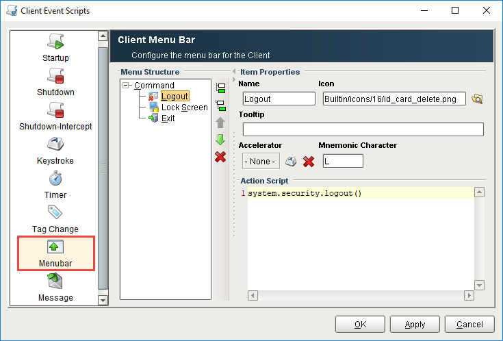

Client Menubar Behavior (Not Available in Gateway Scripts)​
The Client Menubar Scripts create and control the options available in the menubar of the Client. As such, these scripts are only available in the Client Scope. By default, a Client will have three menus: Command, Windows, and Help. The Windows and Help Menu are separate, and controlled through the project properties, but the Command menu is actually created in the Client Menubar Scripts. The default menu structure gives you an idea of how to create a menu.
The top level nodes will show up in the menubar. Each node can have an action script unless it has children. In the image above, the Command object will have a grayed out action script field because it has three children. This allows the Client to click into the menu, and look at what is inside. Children of objects can themselves have children, allowing you to create submenus within your menu. The structure is easy to create, using the buttons to the right to add peer () or child () nodes. You can also move the nodes up () or down () in the hierarchy, as that will affect the order they appear in the Client. You can also delete () nodes that you don't want.
With a node selected you can add to or edit its behavior. Each node can be given a name that it will display in the Client, an icon which will be displayed at the front of the name, and a tooltip that will display when hovering over the menu option. These help to identify what the node is and what it does.
Accelerators and Mnemonics​
Each node can also be given an accelerator and a mnemonic character. The accelerator is a key or key combination that can be pressed at any time in the client to initiate that nodes event. It will display next to the name of the node in the client, and works much like many commonly known accelerators such as Control + S to Save. The mnemonic character is a key that can be pressed when currently in the menu to initiate the node event. If the character chosen is in the name of the node, then that character will be underlined.
Finally, you can set an action script on the node which will determine what happens when the node is selected. Typically this is used for navigation, such as swapping to a new window, or logging out and exiting, like the default nodes. However, you can enter in any kind of script you want.

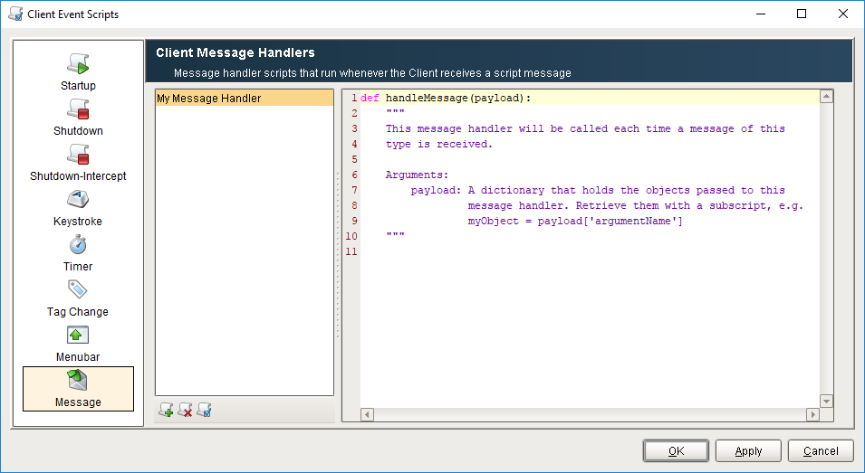

Client Message Handlers​
Located in the Message section of Client Event Scripts, client message handlers will execute in the client. This means if you have five clients open for a project with a message handler that gets called, the message handler will run in each client. You can easily create and manage all of your client message handlers in the Client Event Scripts window. Clicking on one of your message handlers will bring up its script on the right.
Under the list of handlers, three small buttons allow you to add, remove and manage your handlers.
  • Add Message Handler - Will add a message handler.
  • Remove Message Handler - Will delete the highlighted message handler.
  • Modify Message Handler - Will modify the settings for the highlighted message handler.

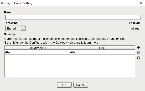

When adding or modifying a message handler, a small settings window will popup. In it, you can give your message handler a name or modify its existing name, enable or disable the message handler, and even select how it executes under the Threading dropdown. There are three different options that dictate how the message handler will execute:
  • Shared - The default way of running a message handler. Will execute the handler on a shared pool of threads, in the order that they are invoked. If too many message handlers are called all at once and they take long periods of time to execute, there may be delays before each message handler gets to execute.
  • Dedicated - The message handler will run on its own dedicated thread. This is useful when a message handler will take a long time to execute, so that it does not hinder the execution of other message handlers.
  • EDT - This will run the message handler on the Event Dispatch Thread (EDT) which also updates the GUI. If a message handler were to take a long time to execute, it would block the GUI from running which may lock up your client. This is helpful when your message handler will be interacting with the GUI in some way, as the GUI will not be able to update until the message handler finishes.
Inside the message handler is your script. The script will have a single object available to it, the payload. The payload is a dictionary containing the objects that were passed into it. Each object in the payload dictionary can be accessed by calling their corresponding key. For example:

Gateway Message Handlers are setup and function similarly to client message handlers. However, there are two major differences:
  • They are setup in the Message section of the Gateway Event Scripts. As such, they are executed on the Gateway.
  • New in 7.9.4
    They have an added layer of security. In the Message Handler Settings, it is possible to configure Security Zone/User Role pairs. The user invoking the message handler must match one of the combinations of Security Zone/User Role listed or else the message handler will not execute.
