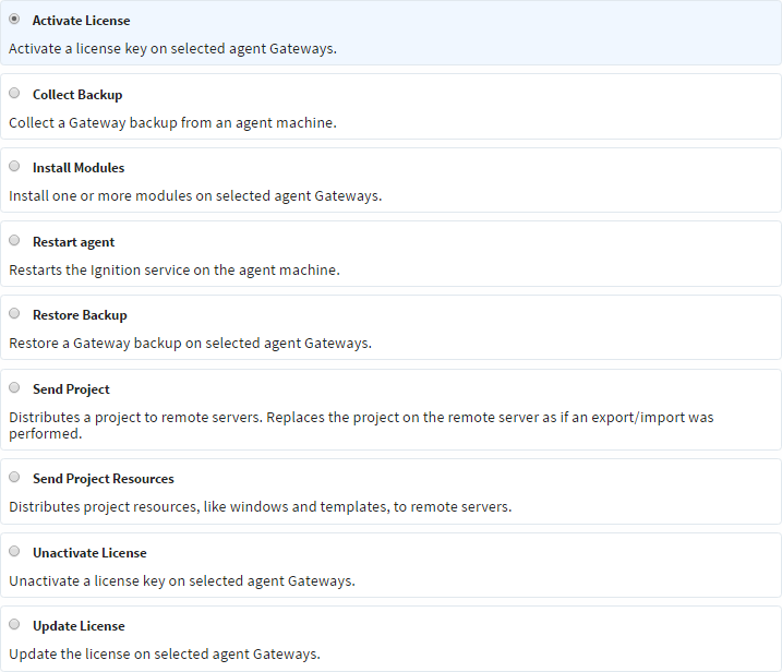

EAM allows you to schedule common Gateway tasks to execute against remote agent Gateways. Tasks are requests sent to an Agent by the Controller. These requests cause the agent to perform some action such as activating a license. Tasks include:
- Activate License
- Collect Backup
- Install Modules
- Remote Upgrade
- Restart Agent
- Restore Backup
- Send Project
- Send Project Resources
- Unactivate License
- Update License

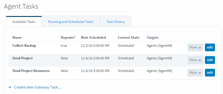

On-Demand or Scheduledβ
Tasks can be executed immediately, scheduled to run once at a later time, or as part of a recurring schedule. Making backups is a breeze with automated task scheduling! Schedules can be freely modified or paused. Scheduled tasks can also execute on-demand, allowing the tasks to be called at will.

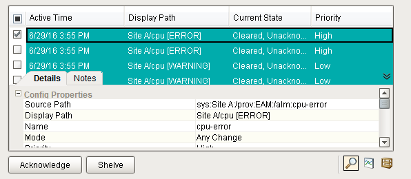

Agent Eventsβ
Every EAM agent sends information to the controller about its general health status. Whenever problems occur on an agent, the controller is notified of the agentβs status in the form of agent events. Problems can include high CPU usage on the agent, large numbers of system errors in a short timeframe, and unusually high usage of database connections. Loss of connectivity to the agent also triggers an agent event on the controller. Agent events are recorded in an external database for analysis and reporting later. Agent events can also be directly configured on the controller to automatically trigger alarms or send alarm notifications.
