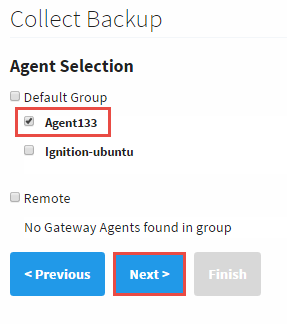

  4. Select the Agent you want to perform the Collect Backup on, and press Next.

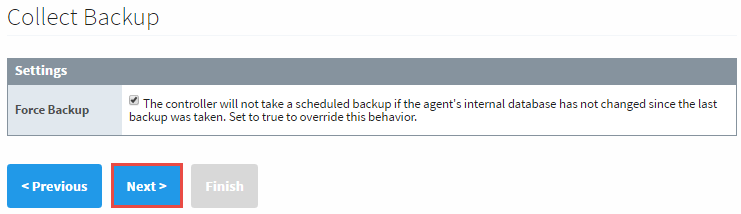

  5. The EAM Task Wizard will prompt you if you want to do a Force Backup even if nothing changed since the last backup. This step is optional, but it is useful when your backups are performed on a regular schedule. It captures the changes between the time the last backup was performed and the unscheduled backup. To be safe, check the Force Backup box, and press Next.

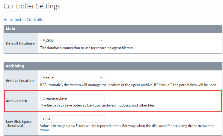

Your new Gateway backup will be stored wherever your Controller settings are pointing to when the Controller was initially created. To check, go to the Controller, and navigate to Configure > Enterprise Administration > Controller Settings. You can have your Archive Path set to Automatic or Manual. If you have it set to Automatic, you can find your backups inside the directory for Ignition, otherwise, it will be the folder location that is specified in the Controller Settings. To learn more about controller settings, refer to Creating a Controller.

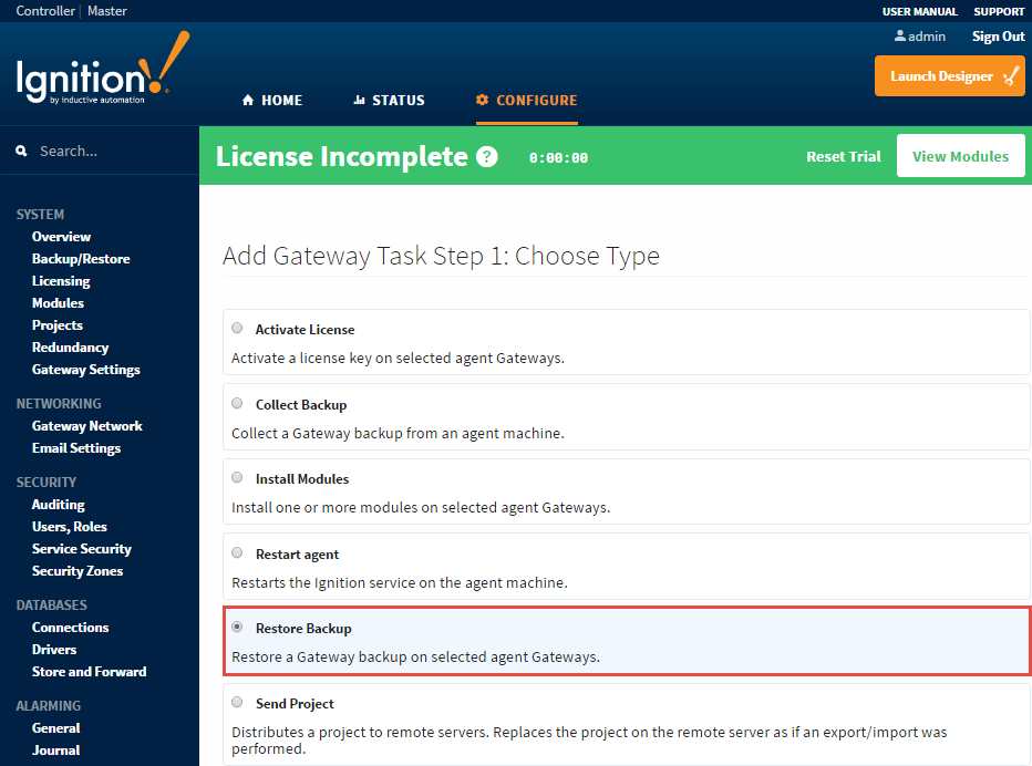

  1. On the Controller, navigate to Configure > Enterprise Administration > Agent Tasks, and click on the Create new Gateway Task link. Select the Restore Backup, and press Next.

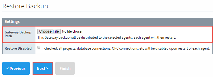

  3. If your Archive Path was set to Manual when you created your Controller, you will have to select the Choose File button, and navigate to the folder on your computer to locate the Gateway Backup file. If you are unsure about your Archive Path, refer to your Controller Settings.
  4. Navigate to the folder on your computer to locate the Gateway Backup file. Select the backup.gwbk, and click Open. Press Next on the Restore Backup task.

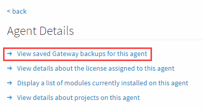

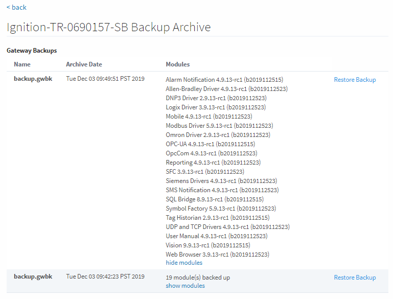

  3. This opens the Agent Details screen with a list of options for the selected Agent. Click the link for the View saved Gateway backups for this agent.
  4. Here you'll see a list of Gateway Backups for the selected Agent. Under the Modules column, you'll see the number of modules included in each backup. Click the show modules link to see all the modules that are included in the Agent backup, then click hide modules to close the module list.
  5. To restore the Agent backup, click the Restore Backup link to the right of the Module column.

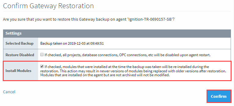

  6. The Confirm Gateway Restoration screen will popup and ask you to confirm restoring the backup on your Agent. Be sure to check the Install Modules box if you want to install all the modules that were running on your Gateway at the time this specific backup was taken. Click Confirm.
  7. After the backup is complete, go back to the Agent Details screen to see the list of modules installed. Click on the Display a list of modules currently installed on this agent link.

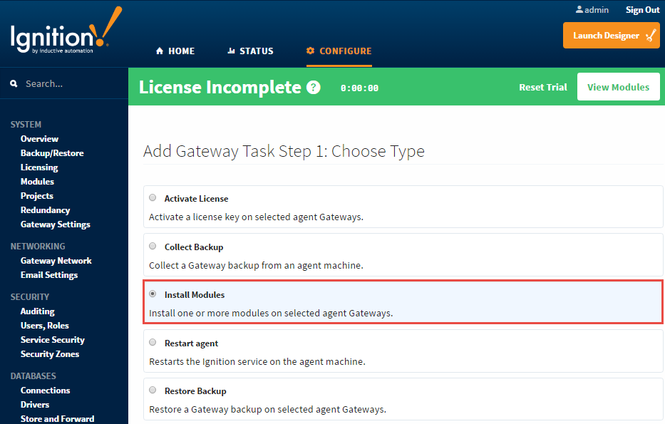

  1. Go to the Controller, and navigate to Configure > Enterprise Administration > Agent Tasks. Click the Create new Gateway Task link. Select the Install Module task, and press Next.

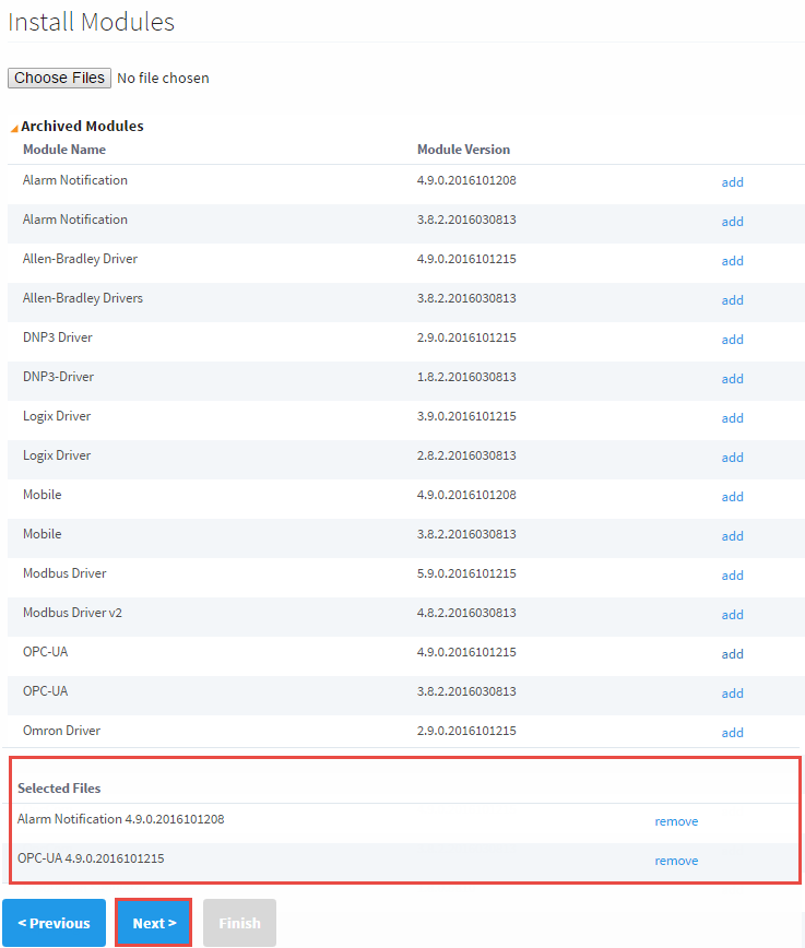

  4. From the list of Archived Modules, click the Add buttons for Alarm Notification and the OPC-UA modules. You will notice, that once you click the Add button next to a module, it will show up in the Selected Modules box at the bottom of the screen. You can choose as many modules as you need, and when you're finished, press Next.
  5. Review the Install Modules Task Summary, and press Finish. Once the Install Module task completes, you will get a successful message from the Gateway Task.

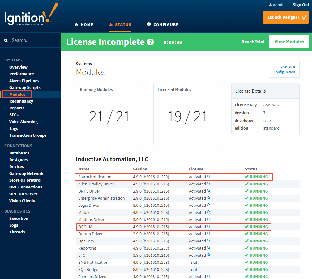

  6. Go back to your Agent, and navigate to Status > Modules to verify that both the Alarm Notification and OPC-UA modules were installed and are running successfully.

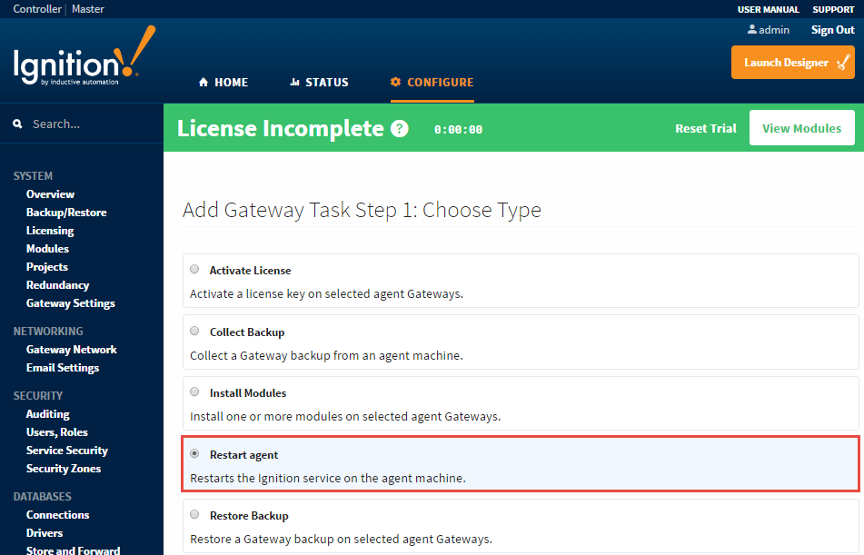

On the Controller, lets create another Gateway Task to restart the agent. This task will stop the Ignition service on the Agent and start it back up again.
  1. Go to the Controller, and navigate to Configure > Enterprise Administration > Agent Tasks. Click on the Create new Gateway Task link. Select the Restart Agent, and press Next.
  2. Schedule the Restart Agent task to Execute Immediately, and press Next.
  3. Select the Agent, and press Next.
  4. Review the Restart Agent Task Summary, and press Finish. Once the Restart Agent task completes, you will receive a successful message from the Gateway Task.
