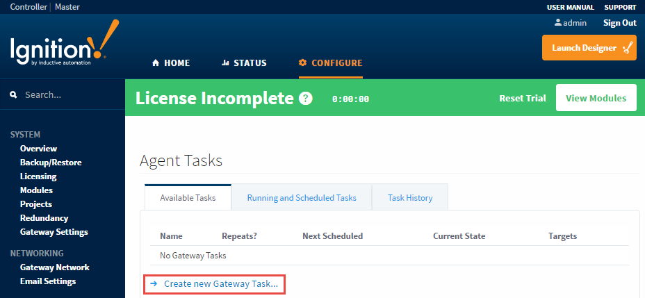

On the Controller, under the Configure section of the Gateway webpage, go to Enterprise Administration > Agent Tasks. Here you can create a Gateway Task to send a project from the Controller to an Agent.
  1. Click the ‘Create new Gateway Task’ link. The EAM wizard will guide you through each step of the Send Project task.

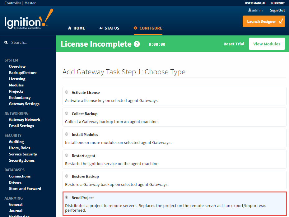

  2. Not only will the Send Project send a project from the Controller to the Agent, but if the project already exists on the Agent, it will replace it. Scroll down the list of Gateway Tasks, and select Send Project. Press Next.

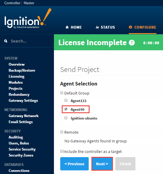

  4. Select the Agent where you want to send your project, and press Next.

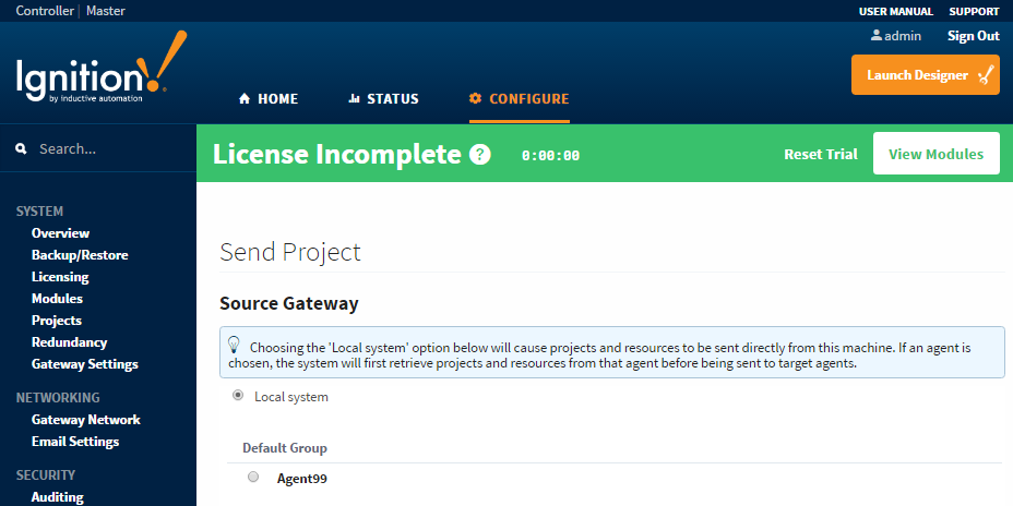

  5. The EAM wizard knows your controller and agent configuration. It’s going to prompt you to choose the machine where your project is located. In this example, the project that you want to send is located on the Controller or Gateway Source so select Local System, and press Next.

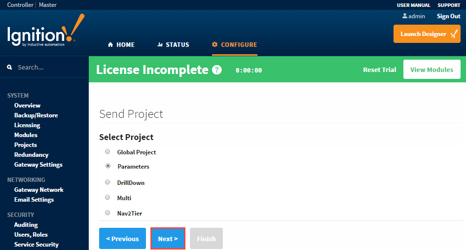

  6. The EAM wizard will display all your projects from your local system. Select the project you want to send to your Agent, and press Next (If you select your Agent on the previous screen, the EAM wizard will display all your projects running on your Agent that were sent over previously from the Controller).

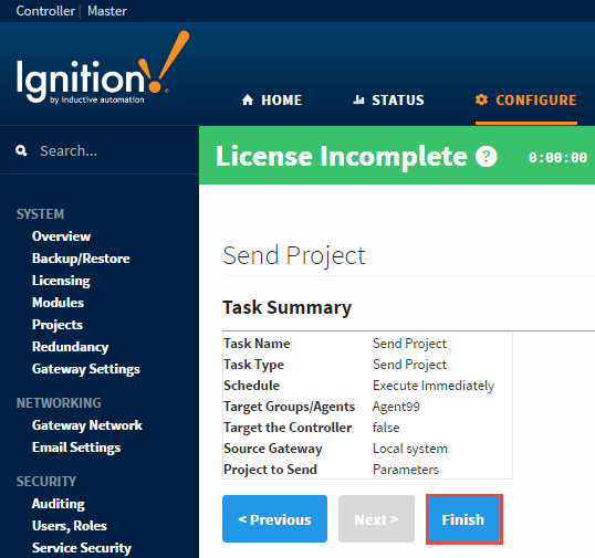

  7. The EAM wizard summarizes all the information for you to review. Press Finish, and your project will be sent from the Controller to the Agent.
  8. The EAM wizard will execute the task, the screen will refresh, and a message will pop up stating that your Send Project task was successful.

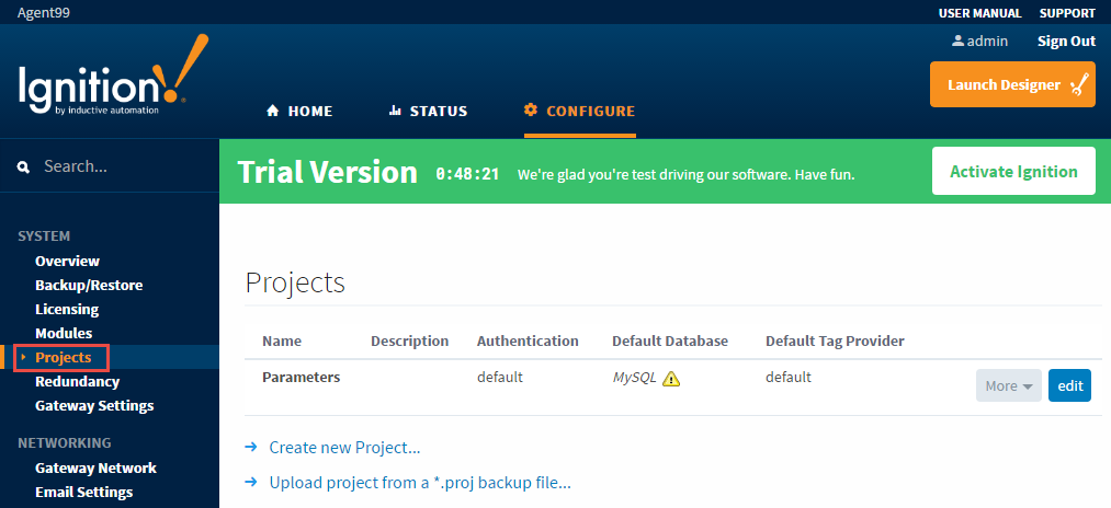

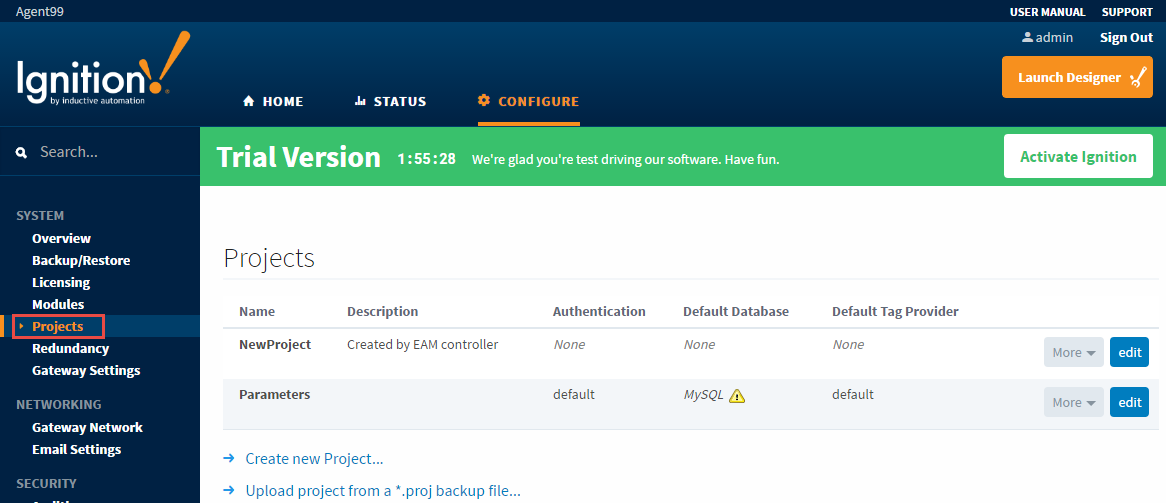

  9. To verify that your project was sent, go to your Agent, click on the Configure tab on the Gateway webpage, and select Projects. In this example, you can see that the Parameters project was created by the EAM controller. If you don't see your sent project, refresh the screen by clicking Projects.
MySQL Warning Message
Notice that for the "Parameters" project there is an warning icon next to the "MySQL" database. This is because the project was configured to use a default database connection named "MySQL" on the Controller, but the Agent that the project has been restored on does not have a database connection named "MySQL".

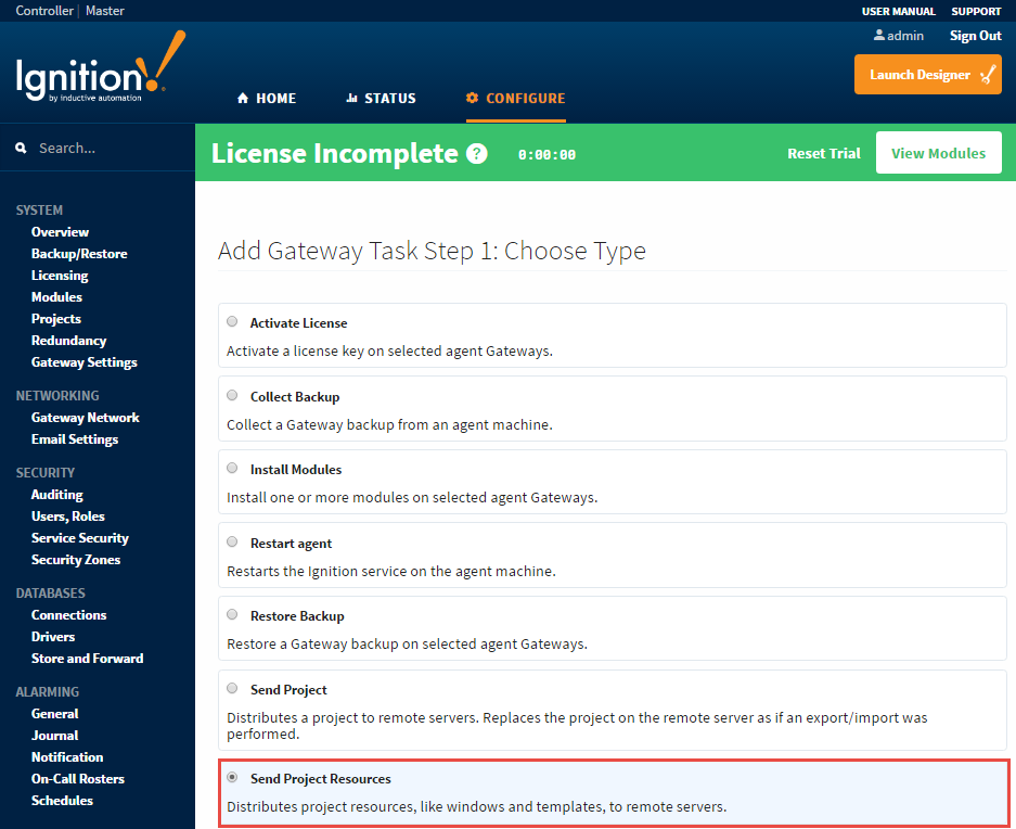

  1. Click on the Send Project Resources radio button, and press Next.

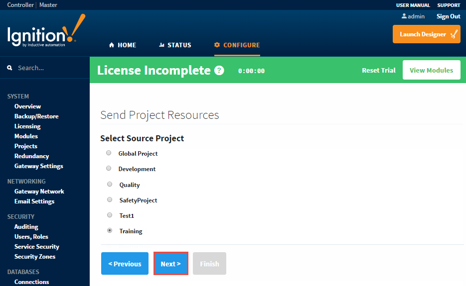

  5. This example sends selected resources from the Training project on the Controller to the Agent. Select Training, and press Next.

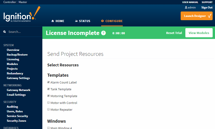

  6. You can see all the resources inside of the Training Project. Of course, real projects will have many more useful project resources than are shown here. It can include templates, windows, transaction groups, pipelines and script modules. Choose whatever resources you want to send to the agent, and press Next.

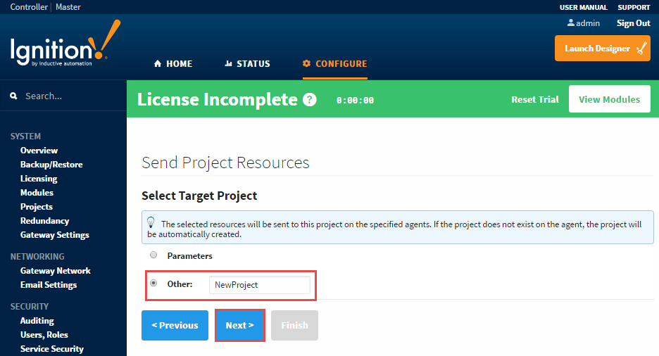

  7. You have the option of either merging the project resources into an existing project or creating a new project on the Agent. In this example, let's create a new project. Select Other, and enter a new project name. Press Next.

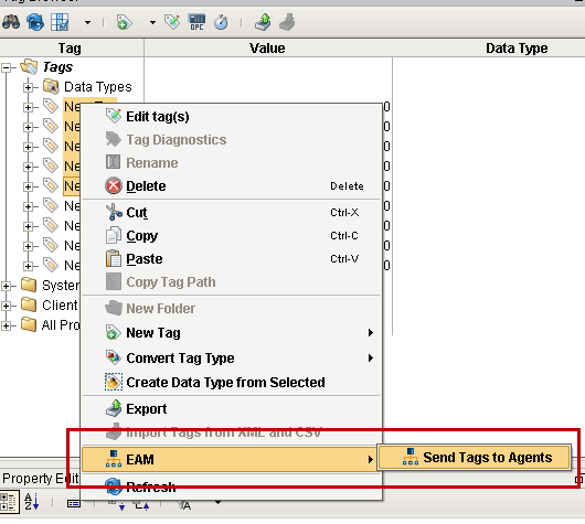

Sending Tags from a Controller Gateway to an Agent Gateway works a little differently than the other Agent Tasks, since the Send Tags Task is executed from the Designer. Within the Controllers Designer, you can select any number of Tags from the Tag Browser that you want to send to any number of Agents.
Right clicking on the Tags brings up the right click context menu, which now has a new EAM > Send Tags to Agents option.

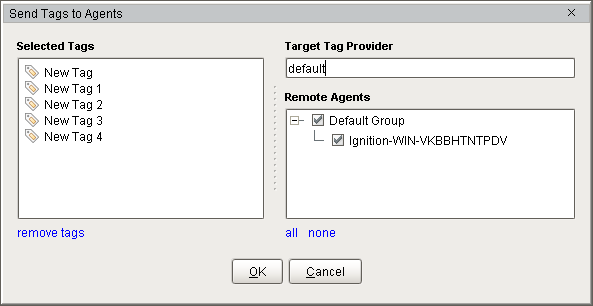

Selecting the Send Tags to Agents option brings up a new window, allowing you to remove any accidentally selected Tags, as well as select which Agents will be receiving the Tags and the Tag Provider to insert them into. Clicking the OK button will begin the process of sending the Tags to the Agents. Once the Tags have all been sent, you will get a new popup, letting you know of the success.
