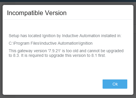

It is strongly advised to first upgrade your Gateway to the latest version of 8.1, if you have not already. There will be compatibility issues if upgrading directly from 7.9 to 8.3, including changes to:
  • Gateway Network
  • Serialization
  • Data syncing, communication, and storage
Error Upgrading 79 to 83
7.9 End of Life (EoL)
Ignition's Long-Term Support (LTS) for version 7.9 ends on June 30th, 2025. This means that 7.9 Gateways will not be supported by neither the development nor support teams past this date. Due to this, it is recommended to upgrade to Ignition 8.1 to continue receiving support, bug fixes, and security updates.
Additionally, it is strongly advised to upgrade either your development or test environment before production. This will help you foresee and eliminate any potentially issues when upgrading, without affecting production. To further reduce any potential issues, your development environment should have similar hardware to your production environment. Upgrading your development environment first will also allow you to see exactly what changes have been made, and how they affect your system.

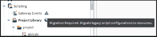

Projects​
After you successfully upgrade to 8.3, you may see an icon in your Designer next to projects that use Gateway or Client Event Scripts. This indicates that one final step is needed to finish migrating your scripts.
Project Migration Needed
The scripts that have this warning are still fully functional and will continue to work without needing any immediate action. The warning will also disappear when you select the resource in the Designer, as the platform will finish migrating that specific resource.
note
Migrated Gateway Event Scripts are located at %IgnitionInstallationDirectory%/data/projects/%ProjectName%/Ignition/%GatewayEvent%/ as .py files, while migrated Client Event Scripts are located at %IgnitionInstallationDirectory%/data/projects/%ProjectName%/Ignition/script-python/%ScriptName%/ as .py files.
During this migration, some resources may need to be renamed to comply with our naming validation schema. Keep in mind that changing a script's name can break existing references within your project. You will need to manually update these references to the new script names and ensure your scripts are organized and up-to-date with Ignition 8.3's file structure.

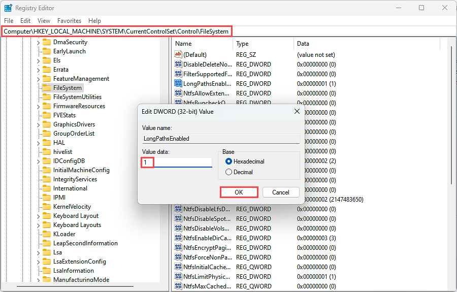

Additionally, due to the Gateway file system changes, tag JSON files are now stored with the path that's shown in the Tag Browser following C:\Ignition\8.3.0\data\config\resources\core\ignition\tag-definition. This change can result in long filepaths, and may impact Windows users since the Windows API has a filepath limit of 255 characters. See the Working with Long File Paths page for more information on how your system may be impacted.
Note that the names of files and directories are still bound by names less than 255 characters long, and this change is focused on the filepaths themselves.
