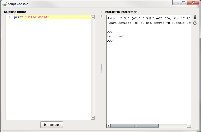

Multiline Buffer​
The Multiline Buffer, located on the left side of the Script Console, allows for multiple lines of code to be entered and then executed by clicking on the button. All print statments will output to the Interactive Interpreter. It also supports code folding for function definitions and comments.

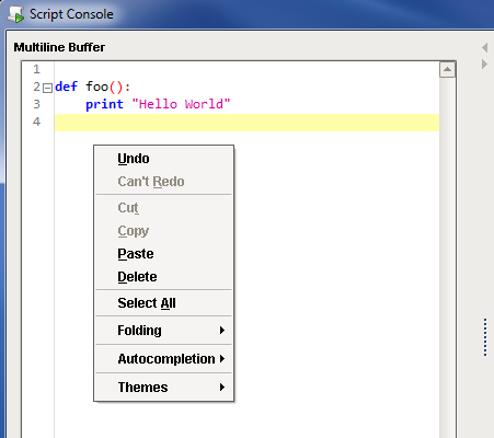

Right Click Menu​
Right-clicking on the Multiline Buffer opens a menu. The menu options are described in the table below.
Main Menu Options
NameDescription
UndoUndoes the last action.
RedoGets rid of the last undo action.
CutCuts the selected text.
CopyCopies the selected text.
PastePastes the selected text.
DeleteDeletes the selected text.
Select AllSelects all text in the window.
Folding
NameDescription
Toggle Current FoldExpand or collapse the fold where the text cursor is located.
Collapse All CommentsCollapse all instances of multi-line comments. Only contiguous comments are collapsible.
Collapse All FoldsCollapse all expanded folds.
Expand All FoldsExpand all collapsed folds.
Autocompletion
NameDescription
Automatic ActivationDetermines if the Autocompletion window to automatically appear. When set to true, the window will appear after a second of inactivity once at least "system." has been typed. When set to false, the window can still be brought up manually by pressing Ctrl+Space.
Show Description PaneDetermines if the Description pane should appear in the Autocompletion window.
Themes
NameDescription
DefaultUses the default theme with light background, dark characters.
DarkUses a dark theme with dark background, light characters.
Visual StudioUses a theme reminiscent of Visual Studio. Light background, dark characters.

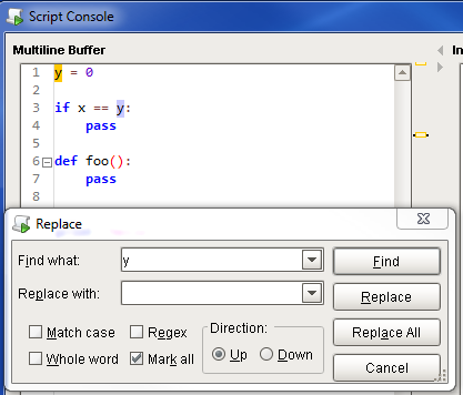

Find/Replace​
Pressing Ctrl+R while the text cursor is in the Multiline Buffer opens a Find and Replace window. This will search for instances of text throughout the Multiline Buffer, and allows the user to replace all or some instances with new text.

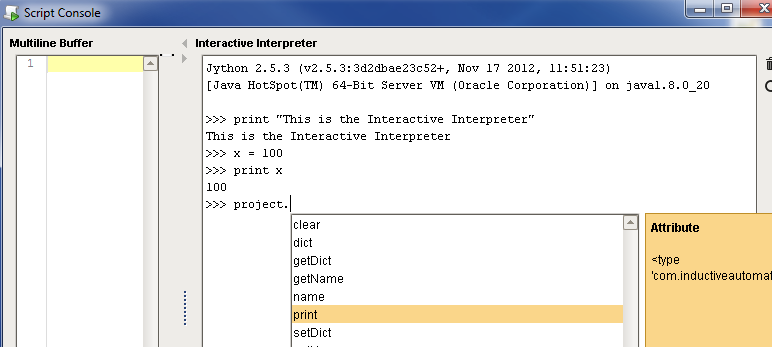

Interactive Interpreter​
The Interactive Interpreter is located on the right side of the Script Console, and allows you to run a single line of code at a time. Code is executed from the Interactive Interpreter by pressing the Enter key. Print statements from both sides of the Script Console will appear in the Interactive Interpreter.
The Autocompletion window, available in the Interactive Interpreter, has access to the current working environment so items such as Project and Shared scripts will automatically appear. They can also be typed in manually.
