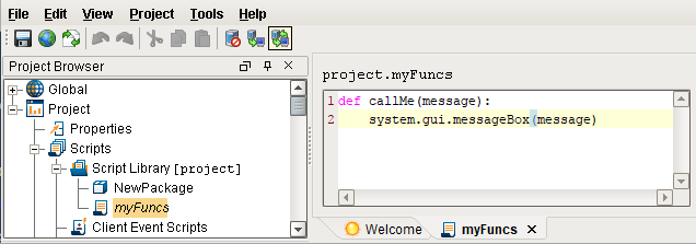

For example, let's suppose you added the following script module named myFuncs, whose body is shown below.
Python - Project Script
def callMe(message):
system.gui.messageBox(message)
Now, anywhere in your project you can call this function.
Python - Calling the Project Script
project.myFuncs.callMe('Hello World')

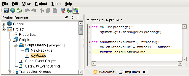

Because each module can hold many functions, you can add any functions you need to this Script Module.
Just like before, you can call this function using:
Python - Calling Different Functions
result = project.myFuncs.addNumbers(14, 87)
Note, that the addNumbers function also has a return value. This will be returned to the script that called the function, allowing you to use it within that script.

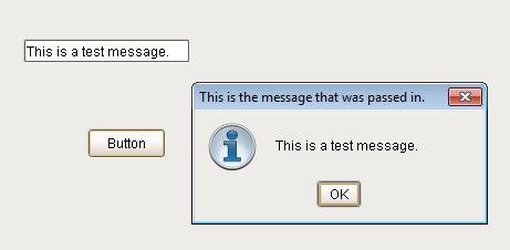

  1. Save the project. The project script that we created in step 2 will not be available to use until it is saved.
  2. Try it out! Type a message into the text field and then click the button. You should see a message box popup with your message inside.

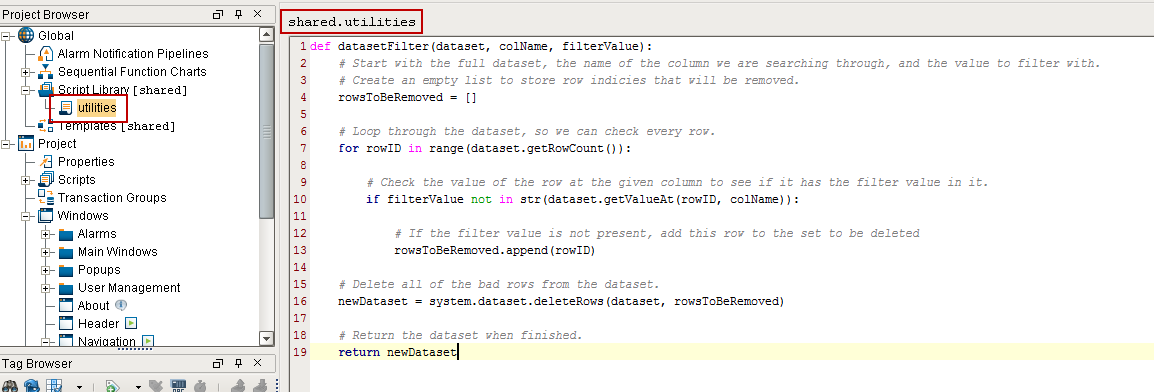

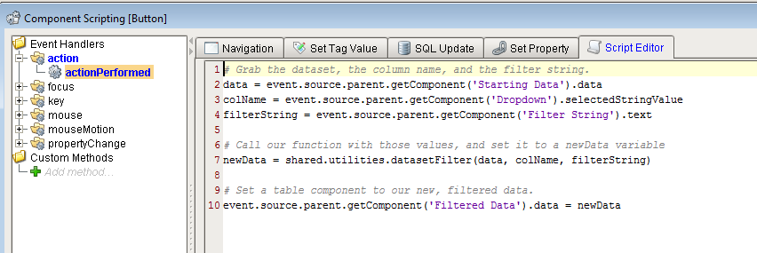

Filtered Dataset Example​
In this example, we can use a shared script to filter a dataset in any project. The script takes in a dataset, a column name, and a filter string. It will then remove any of the rows that do not contain the filter string in them.
Python - Dataset Filter
def datasetFilter(dataset, colName, filterValue):
# Start with the full dataset, the name of the column we are searching through, and the value to filter with.
# Create an empty list to store row indicies that will be removed.
rowsToBeRemoved = []
# Loop through the dataset, so we can check every row.
for rowID in range(dataset.getRowCount()):
# Check the value of the row at the given column to see if it has the filter value in it.
if filterValue not in str(dataset.getValueAt(rowID, colName)):
# If the filter value is not present, add this row to the set to be deleted
rowsToBeRemoved.append(rowID)
# Delete all of the bad rows from the dataset.
newDataset = system.dataset.deleteRows(dataset, rowsToBeRemoved)
# Return the dataset when finished.
return newDataset
By placing the script in a shared script called utilities, it can be used by any project, allowing us to filter a dataset no matter what the data is.
It can then be called in a project on something like a button component using shared.utilities.datasetFilter().

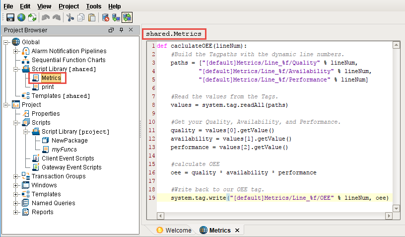

Calculate OEE Example​
In our projects, we use a fairly simple script that calculates OEE, and writes it to a Tag as shown below.
Python - Calculate OEE
def caclulateOEE(lineNum):
#Build the Tagpaths with the dynamic line numbers.
paths = ["[default]Metrics/Line_%f/Quality" % lineNum,
"[default]Metrics/Line_%f/Availability" % lineNum,
"[default]Metrics/Line_%f/Performance" % lineNum]
#Read the values from the Tags.
values = system.tag.readAll(paths)
#Get your Quality, Availability, and Performance.
quality = values[0].getValue()
availability = values[1].getValue()
performance = values[2].getValue()
#calculate OEE
oee = quality * availability * performance
#Write back to our OEE tag.
system.tag.write("[default]Metrics/Line_%f/OEE" %(lineNum), oee)

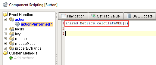

Instead of copying this script between projects and throughout all of the windows that need it, a Shared Script Module was created in the Shared Script Library called "Metrics." The code was copied and pasted into the scripting area in the Shared Script Library.
This could then be called from a script in any project by calling shared.metrics.calculateOEE():
