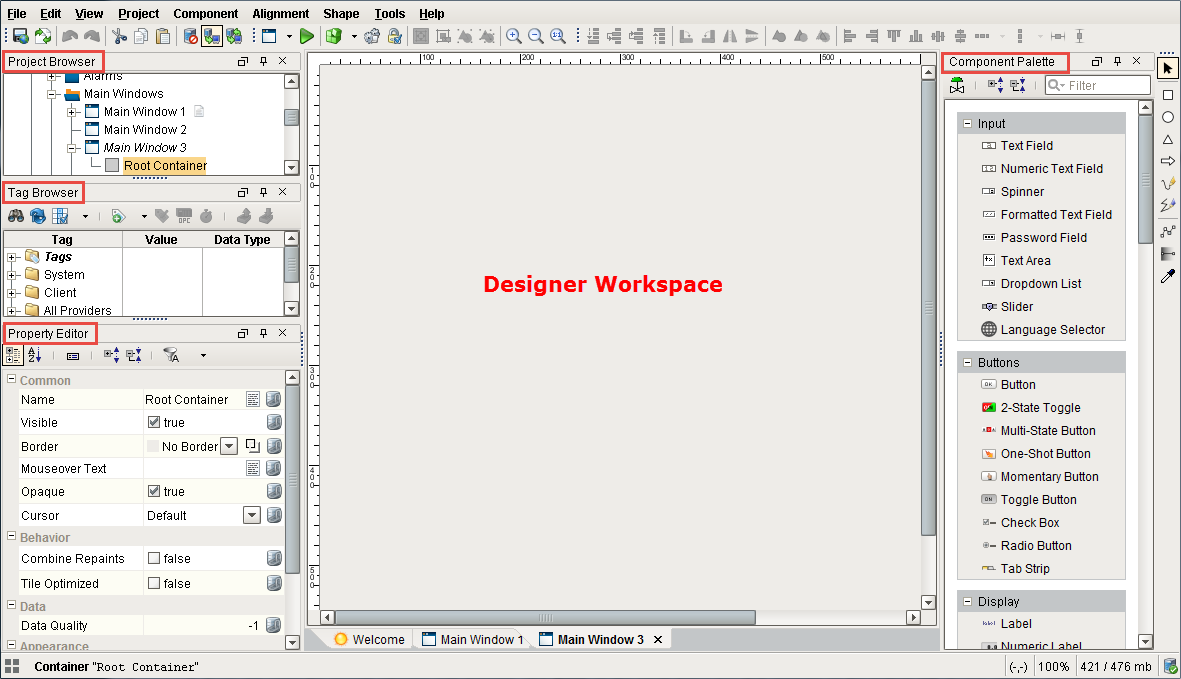

Designer Workspace
The Designer is organized in panels around a central workspace. Some of these panels include: Project Browser, Tag Browser, and Property Editor. The workspace changes depending on the type of resource that you are currently editing. For example, if you are editing a Window, your workspace will be the Window Designer. If you are editing a Transaction Group, your workspace will be the Transaction Group Editor, and so on.
There are many dockable and dragable panels that surround the workspace, as well as the familiar menu bars and toolbars. The dockable panels can be rearranged as you wish and will snap into place as you move them around the screen. Each type of workspace can have panels that are only valid when that workspace is active. Each workspace remembers its own perspective, which is the docking arrangement of the panels around it.
If you have closed a panel and want to get it back, re-enable it from the View > Panels submenu. The View > Reset Panels will reset the user interface back to its default window arrangement.

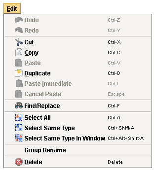

Edit Menu
The Edit Menu is also similar to other applications edit menus, in that it provides much of the basic copy/paste functionality.
| Function | Description |
| Undo and Redo | Can be used to revert to the previous state, essentially removing the last change, or redoing it again after having been removed. This has a large queue that can be traversed but does not include every change. ie: Tag edits cannot be undone. |
| Cut/Copy/Paste/Duplicate | These function much the same as they do everywhere else. Most things in the Designer can be copied and pasted elsewhere, from individual components on the window to entire folders of windows. The difference is that when using paste with an object on a window, it will instead create a paste action, and allow you to move the mouse and select where you want to paste, clicking the mouse to confirm. Cancel Paste will cancel the paste action, while paste immediate will bypass the paste action, and instead immediately paste the object from where it was cut or copied from |
| Fine/Replace | Brings up the find and replace interface to allow you to find specific objects within the project. See also: Find and Replace |
| Select All | Selects all siblings in the same container as the currently selected component. |
| Select Same Type | Selects all components of the same type in the same container as the currently selected component. |
| Select Same Type in Window | Selects all components of the same type as the currently selected component, regardless of what container they are in. |
| Group Rename | Renames a group of components to a prefix with a number afterwords. For example, if your prefix is Button, it will rename all selected components Button (1), incrementing the number each component. |
| Delete | Deletes the currently selected component. This can also be done using the delete key. |
