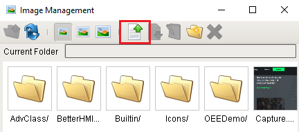

Alternatively, the Image Management window has an Upload button to pass images in. Locate the directory you wish to upload the image. You may use the root folder, or create a new folder to keep your images organized. When ready, click on the Upload Image button.
Image Management Manual Upload
An Open dialog window will appear. Simply find your image on the local system and click Open to upload the selected image.

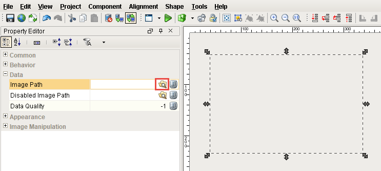

  2. From the Property Editor, select the image component's Image Path property, click on the Browse icon.
    Using the Image Component on a Window Step 2

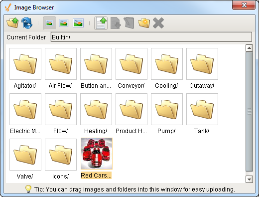

  3. From the Image Browser, look through the different folders for an image file you want and double-click on it to display it in your window.
    Using the Image Component on a Window Step 3

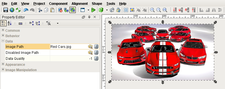

  4. The path to the image is now displayed in the components Image Path property.
    Using the Image Component on a Window Step 4
