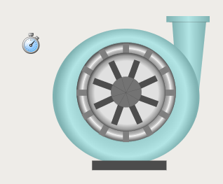

To actually move components around during runtime usually involves binding all or part of an image or svg to the value property of a timer or signal generator. The symbol factory components all contain an Angle property. Binding the Angle property of a spinning part of a motor can help us visualize when the motor is running or not.
  1. Pick out a component that you would like to animate. I used the Single Stage Compressor from the Symbol Factory. You will also want to grab a Timer Component.
    components that actually move step 1

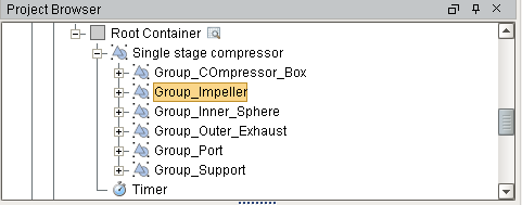

  2. Expand out the Single Stage Compressor component. You will notice that the whole component is made up of many smaller pieces. We want to select the piece called Group_Impeller.
    components that actually move step 2
  3. Bind the Group_Impeller's Angle property to the Value property of the Timer.
  4. We now need to modify the properties of the timer to ensure a good rotation. Set the Delay (ms) to 200, the Step By to 10, and the Bound to 360.
  5. You should now be able to set the Timer's Running? property to True, and your component will now animate. You can adjust the Delay (ms) to be lower or higher to adjust the speed at which the component rotates.

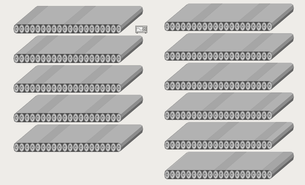

  2. Duplicate this component 10 times for a total of 11 conveyors.

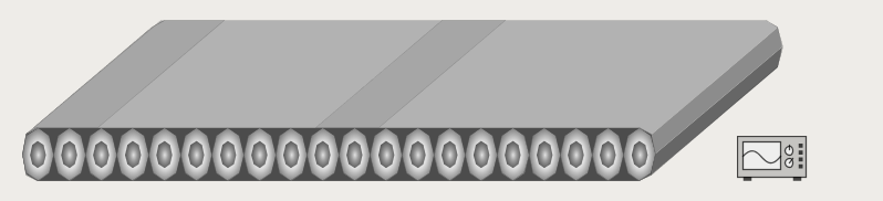

  3. Select the first instance, expanded the Group_Conveyor_Belt, and moved the Path 4 and Path 5 Components. On this instance, I moved them both an equal distance left so that the leftmost component is on the left edge of the conveyor.
    Giving the Illusion of Moving Step 3

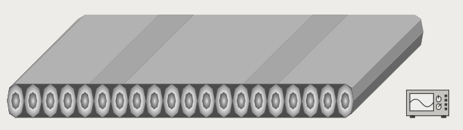

  4. Repeat this with the rest of the components, except move them slightly to the right of the previous instance. Notice how the gray bars slowly move from left to right over all the components when viewed in sequence.
    Giving the Illusion of Moving Step 4
