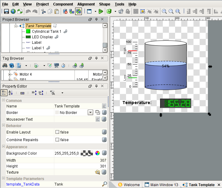

Template Properties​
Template Properties (called Template Parameters) allow each template instance to reference different data. Because the primary use of templates are the ease of maintaining repeated user interface elements, correct use of Template Parameters is very important. This is very similar to the concept of Parameterized Popup Windows. In that case, any Custom property on the Root Container of the window is used as a parameter, and is passed into the window when it is opened. With Templates, you have a property in the root of the master template that is exposed when you drop a Template Instance on a window.
Template Parameters and Internal Properties​
When you open the Custom Properties window (right-click the checkered-box of the template and select Customizers > Custom Properties), you'll notice it is different than the Custom Properties of all other components. There are two kinds of custom properties here, as follows:
Template Parameters​
These parameters appear on each template instance, allowing each instance to be configured differently. Commonly, this is some sort of indirection. For example, if you have a template representing motors, you might have MotorNumber as a parameter property. Then you can use that property as an indirection variable in other bindings within the template. Parameter properties are not bindable from within the template master design. When you use the template to create a template instance, the property becomes bindable. This ensures that the property only has a single binding configured for it.
These properties cannot be used as parameters in your instances. They show up when designing the template master, but it does not show up on the template instances. Internal properties are bindable from within the template master design. These properties are intended to be used for the internal workings of the template.

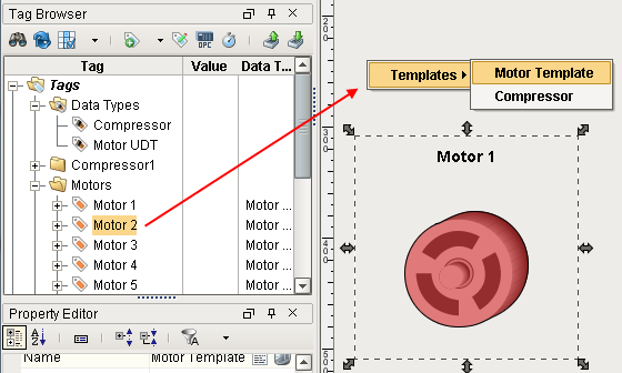

The Drop Target Parameter​
When you specify parameters in the Custom Properties window (right-click the checkered-box of the template and select Customizers > Custom Properties), you can set one of the parameters as the Drop Target. This allows you to drop a Tag of that type onto your template instances or onto a window to facilitate even quicker binding. For example, let's say that you have a parameter that is an integer and you've made it the drop target. If you drop an integer tag onto a window, your template appears in the menu dropdown list of components which is displayed. Choosing your template creates a template instance and binds that parameter to the tag.
This also works for UDT tags. Lets say you have a custom data type called Motor and a template with a Motor-typed parameter set as the drop target. If you drop a motor tag onto a window, it creates an instance of your template automatically. If you have more than one template configured with Motor drop targets, you have to choose which template to use.
