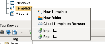

  1. In the Project Browser, right-click Templates and select New Template.
    A checkered box is displayed in the design space where you design your template. The checkered box means that the template is completely transparent. You can set a background if you want.

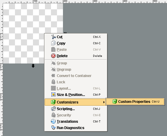

  3. Right-click on the background and select Customizers > Custom Properties.
    The Custom Properties window is displayed. Here you can set both the Template Parameters and Internal Properties. Template Parameters appear on each template instance, allowing each instance to be configured differently, like an indirection variable. Internal properties show up when designing the template master, but they do not show up on the template instances.
