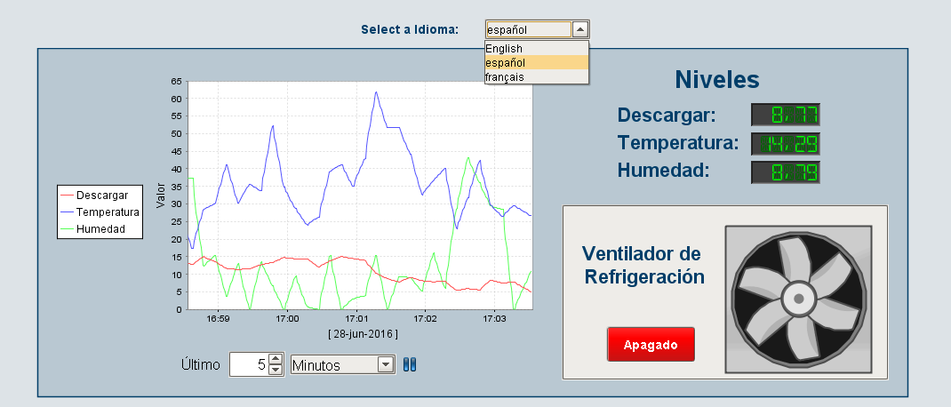

Localization allows you to translate text into multiple languages in a project for display on client screens. The localization feature allows users located in different countries to set their default language so client screens can be displayed in their native language. The user can easily choose which language their Client displays with a click of a button! Text contained in components, that have their properties correctly mapped with localization, will change to reflect the language the user has selected. There is a special Language Selector component that requires no set up at all! It's a simple dropdown list that displays the language options for these translations.
Just pick the language you want and all the text on the window will be displayed in the language the user selects.
Change all Text just by Selecting the Language​
It's simple to switch the current language in your project. Ignition has several easy ways to change language settings.

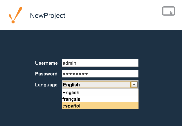

Login Screen​
One way you can select your preferred language is on the Login screen. There is a dropdown list that automatically appears as soon as you add a second language to your project.

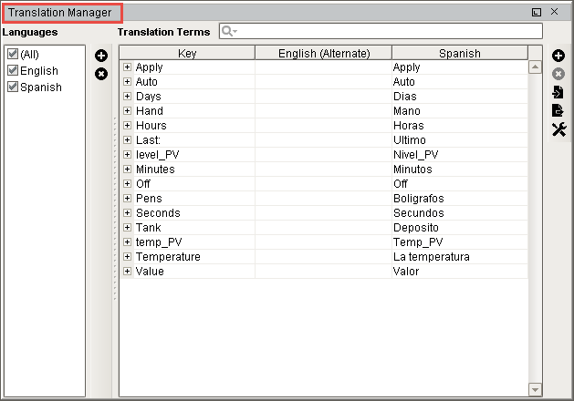

Store All Translations in One Central Location​
Translation Manager​
All translations are stored centrally in the Gateway and are distributed to each Client and Designer. All projects share the same translations, and those translations can be used in other locations, such as Gateway scripts, and alarm messages. The full translation database can be viewed and edited in the Translation Manager panel located in the Designer. You can add new terms and phrases to the Translation Manager. Make your phrases as long or short as you like with single words or whole paragraphs. It allows users to easily import and export translatable components and share them across projects and with other users. It also has the ability to define new languages.
A central term database and support is automatically built into all component text properties, as well as other text-based properties, such as alarm messages. Aside from defining translations for terms, there is usually no other work needed to take advantage of the translation system.
Translation Database and Term Lookup​
Terms are referenced in the translation database using direct string comparison. Ignition has special term Keys that are used to identify when to translate text. The base term may be a user-readable string such as "Start", or any special code you want such as "START_COMMAND" or "#start", which would have an alternate translation for English defined as "Start." This way you can quickly Identify which terms will be translated when working in the Designer. To keep things simple, the English key is automatically used if no match is found for the requested language.
